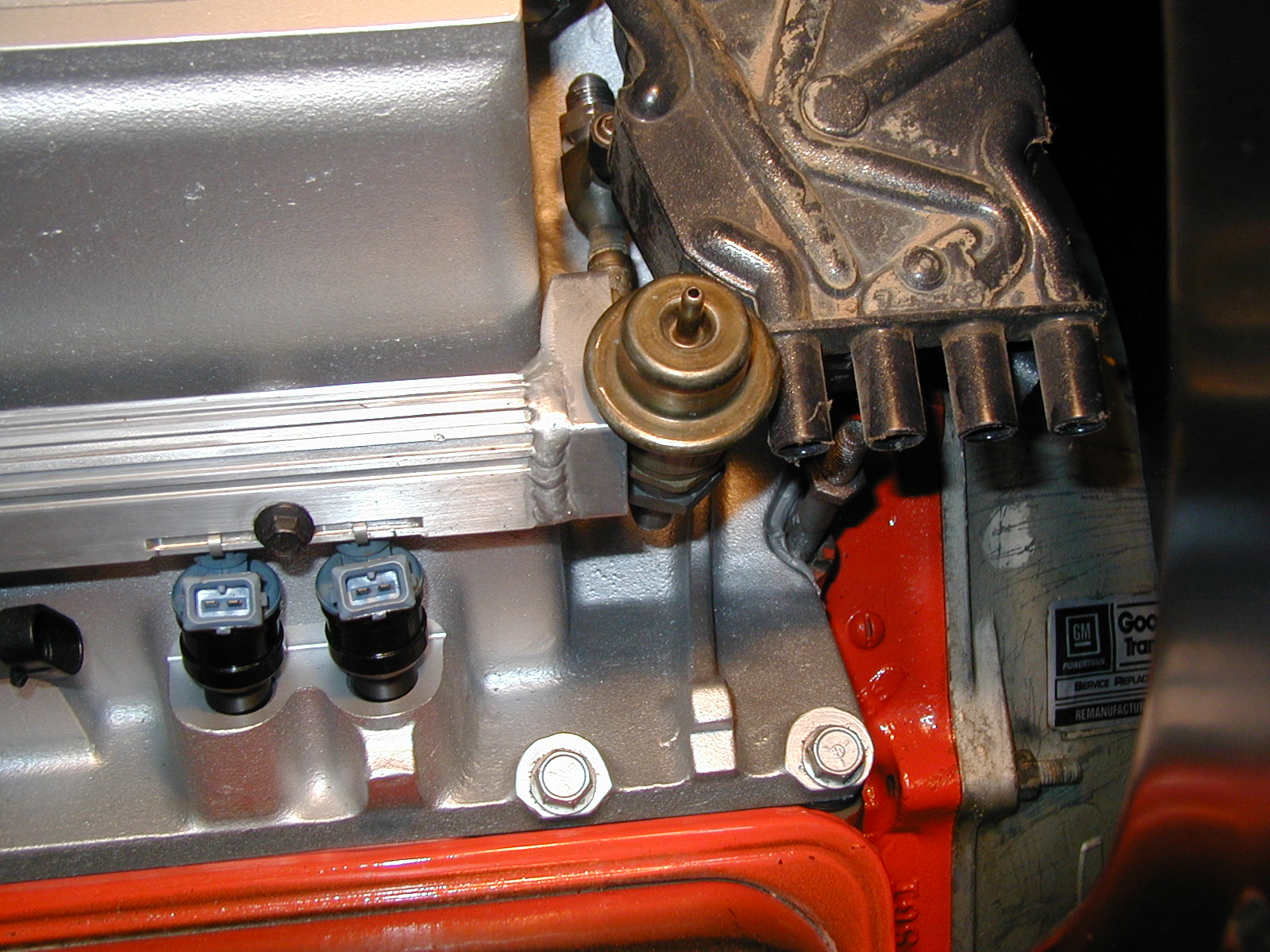

I finally got my heads back from port shop, and went to change them and found out that I had one cylinder wet for a couple years while engine was sitting in 58 vette at body shop. Had to tear down and sleave one cylinder and rebuild this week. I fnally got engine back together and heads on today. I took a couple pictures of the timing cover and L31 stuff that goes on front of engine. When I get back Monday, I'll get Ramjet intake on the engine, bolt up trans and drop drivetrain in the 41 pickup I chose to use for project. I took a 350 TBI/4L60E with a 93 harness/ecm out in order to go with this project. I may be sorry I did in the long run, but it's still sitting in shop floor in case this deal goes south.
I test fit my L31 dist to the Ramjet setup yesterday, and found out that I'm going to have to do a lot of work on fuel rails to clear funky dist cap on the vortec. It's flat with 4 plug wires coming out each side that hit both fuel rails where fuel goes in and out. I'll deal with that Monday, a friend that can tig weld is going to help me then. I don't think the TPI setup will cause the same problem, but I'll check it out and get pictures also then.
The engine I'm using came out of a L31 98 truck, but when I put it in the vette, I took all the L31 stuff off and threw it away, ( how many times have I done that?). So I had to visit my buddie's junk yard and round it all back up.
When you change the timing cover to the truck plastic one, you'll have to pull the two line-up dowel pins in block for lining up metal cover. The plastic cover has them attached to cover. The timing wheel goes on after timing gear, and is lined up with notch to crank key.
I asked several of my mechanic friends if used covers were okay and they all assured me that as long as they were clean, and in tact, and a new balancer seal was in, it was okay.
When you get your cover and timing wheel, don't forget to get mounting bolts also. The plastic cover uses a totally different bolt.
I'll report more progress next week.
Pictures of cover and wheel attached.
Thanks,
Ron

Here's pics of the vortec dist in a TPI intake, which gives great clearance. The Ramjet fuel rails had to be cut, shortened, and re-tigged, and re-routed on right side, but dist works great now.

I shortened and angled the rear of both rails so the dist would not hit. See above picts.

I took a piece of billet alum and drilled it to match up with fuel hole in right side rail after I had shortened it and cut at an angle so I could run the fuel outlet down and screw in an AN fitting in it. Then just TIG it up good and check for leaks. The right side was worst. I could only shorten right side a small amount and then angle cut back of FPR bracket and TIG it up.
Both side mods took me about a couple hours and a good friend about 30 minuites to TIG back up.
I looked large for different dist cap with no luck. The original L31 had a big ugly breather in that area that covered everything, so there was no room.
Ron

OK then, time to ask for some help.
I've gotten further along with this project.
- 99 L31, Etec200 heads, 224/230 0.580/0.570 cam, 383, flattop
- Double roller timing chain
- StealthRam
- 99 L31 stock PCM
- 42#/hr injectors (bit much but that's ok)
So here's my problems:
- Crab-type distributor hits the fuel rails where the wires come out on the sides. Do they make a vertical-wire version?
- If I was to transplant the pick-up stuff from the stock distributor over to a MSD-standard-type, think I could get away with that? The 'stock' pickup is a half-crescent magnetic 3-wire pickup.
- Reluctor wheel at the front of the crank hits the double roller. If I shim it out, I'll have to cut back the balancer. Isn't there a 'specialized' reluctor available for this sort of application?
As it stands, I'm planning to spend some quality time on the metal lathe and mill building the following:
- Hub 'adapter' to replace the existing MSD paddle-wheel with a step-up 'platform' with set screws that will secure the 'stock' style distributor-mounted cam position reluctor.
- Special 'stepped reluctor' for the crank snout that will relocate the outer edge of the reluctor earlier in the diameter to escape the roller chain clearance.
Any ideas? Maybe something available from crank builders (Callies, etc) on that reluctor? Maybe an 'alternate' part source from a different year/model application that has some stuff in common distributor-wise on that cam reluctor without having a crab-style cap?
Got this motor just itching to go in! Last few details (as usual!).

I don't know of a vertical-wire type for the vortec engines, although there might have been one for the big block motorhome or something.
Which brings me to the reluctor, the 350 Vortec was available in alot of HD applications as well. I would go into your local GM HD parts division and have them take a look at what is available.
What about a crank reluctor from a 1996 LT4?
My S-10 is using a Cloyes double roller timing chain. I'm also very interested in a solution to this problem.
