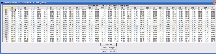

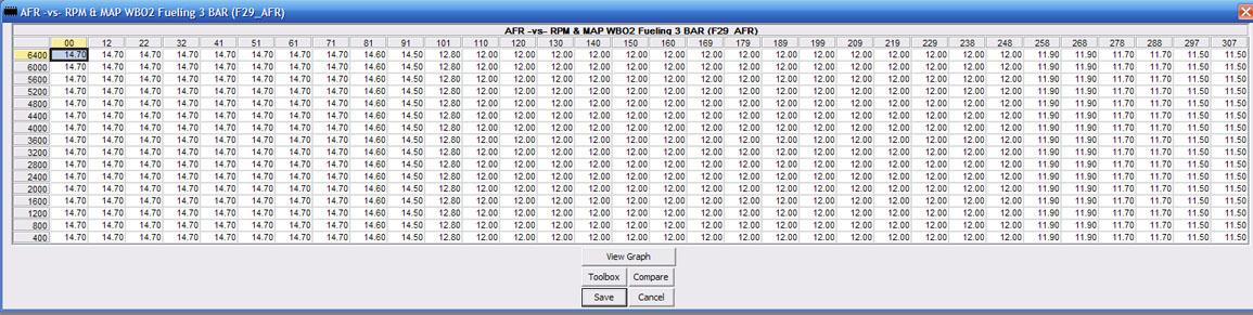

Here are a few more snap shots of what is coming.
Closed Loop Wideband.
Here is the list of sensors that will be selectable on the fly to use. These are all based of Digs patches.
DIY / TechEdge v1.0 Sensor (Nonlinear Output)
FJO (Nonlinear Output)
AEM Nonlinear Output
TechEdge v2.0 (Linear Output) [AFR = (Volts * 2) + 9]
PLX Linear Output [AFR = (Volts * 2) + 10]
Innovate Linear Output (1V - 2V) [AFR = Volts * 10]
AEM Linear Output [AFR = (Volts * 2) + 10]
Zeitronix (Nonlinear Output)
And then a RAW output for unknown sensors but that is only for ALDL output. You can't use any of the WBo2 fueling with the Raw sensor setting.

woah! ty.... explain the use of that wb afr table? is that afr table what the ecm wants? will it look at the wideband o2 and if it's not getting that....make it that?....that would be too easy huh?
The logic for that table is in early stages. But basically you are correct. It goes to VE table, figure out BPW, then watches your WB o2 and compares to desired. Makes adjustments if needed.
Again logic is early stages but working fine for NON PE, AE modes at this time.

What we have done is allowed you to actually turn OFF the closed throttle table and just use the new larger F29x table.

The F29_AFR table is not a cure all. You still need to get your VE's close. Since this is currenlty only USED when in closed loop and when PE (which is anything in Boost) is not active. We are still hammering out the algorithm for the Wbo2 Code and when it should be active. So right now this table works when crusing/Idle. During testing, I dropped all the 14.7 AFRs in the table to 15.2 and then 16.0 to see how well it worked. The code is very fast to make the corrections when you make a change to the table and it is spot on. It will still fluctuates +/- .2 AFR like it normally would on NBo2 but it keeps you around the AFR you want.
Hopefully we can get a highway mode added for Better fuel economy. If we don't get a highway mode added, you could still use this table to make it work like it. Get your VEs correct, then dial in the AFR table to a lean AFR for better fuel economy. Then the minute you get on the gas AE/PE kick in and over rides the table and then VE table comes back into play. So it is a step. I was getting around 18-20 MPG just playing with it on the 15.2 AFR. (This is with doing serveral boost runs and launches) I am sure there is more you can get out of it. This could all change if we change how the Wbo2 fueling algorithm works.

Lookin' good. I am curious why you went with one large table instead of breaking it up into two smaller tables.
Tunerpro doesn't allow the table to float so the RPM values will be hidden when editing the higher KPA areas.
Not knocking it, just curious.
Did you translate the WBO2 signal into a NBO2 signal and use the stock type BLM and INT updates? Or did you
re-write the correction algorythm?
I have been thinking of trying a simple WBO2 --> NBO2 signal mapping function for the $8D to see how it works.

I'll let 1981TTA answer the WBo2 Fueling since he wrote it. I know he said it uses the normal BLM routines for the correction. When I look at the asm I can see where he jumps in but I don't know all the ins and outs of the code. He would be your best bet to explain it. Also we are still working on when to use the Wb02 for fueling. Right now we don't use it when in PE. This could change.

Essentially, that's exactly what happens. I compare the WB sensor to the Desired AFR. From there, the rich/lean bit is set accordingly. My intention was to keep the INT/BLM behavior the same on the WB as it is on the NB so that existing VE correction spreadsheets/applications would still work. (As skwayb mentions above, you still need reasonable VE tables with this system.) The "tricks" are determining what to turn off vs. what to leave running in the NB closed loop logic. Things like NBO2 voltage thresholds no longer hold meaning in the WB world the way I did this.
I am not sure how well it will work out. I like to try and use most of the stock logic and just get more accurate on the timing & fuel.
What are you using for a LAG filter coefficient for the WBO2 variable?

I don't have any filter implemented on the WBO2 signal. I expect this may change as different sensors are tested against the algorithm. My Zeitronix sensor behavior was "clean" enough to use "raw". (Actually, I should also check the schematic to see the characteristics of the MAP2 input filtering on the ECM. It might be that the signal is "clean" in the code because the hardware filtering made it that way!) Nothing like the statistically significant sample of "1" to make a knowledgeable decision!
Hopefully, with more people testing with a diverse array of sensors and engines, things like filtering requirements and "sensor ready" algorithms can be made more generic.

The guys testing have noticed that driveability got considerably better with
using the single table; presumably because it eliminates the possibility of broad
tuning gaps when switching between the closed throttle and open throttle tables.
The code didn't really "fix" anything per se, it just made the tuner
more aware of adjacent cells.
One thing we also did, for better or worse, was to *not* use the normalized map
variable for table lookups, and just used the filtered var instead. This
simplifies things greatly for tunerpro, in terms of making the "bubble" behave
properly.
Later,
Dig
new code down to one big fuel table, one big timing table, and boost control.
(If you need that) This reduces the complexity for the average guy trying
to get things running decent.
The sizes themselves (16x32) are a function of what the table routines will
handle. I had to hack the existing routines such that they would allow a
table bigger than 256 without wigging out.
I actually wrote a whole new 3d routine, before I realized that my routine was
functionally the same as the GM-designed ones, only fatter. It was a good
exercise, though, it made me realize what the GM routines were actually
doing, and what some of the system limitations are.
It does end up taking longer to dial the big table in, but the other guys got
a project cookin' to reduce a lot of the manual labor.
Later,
Dig
