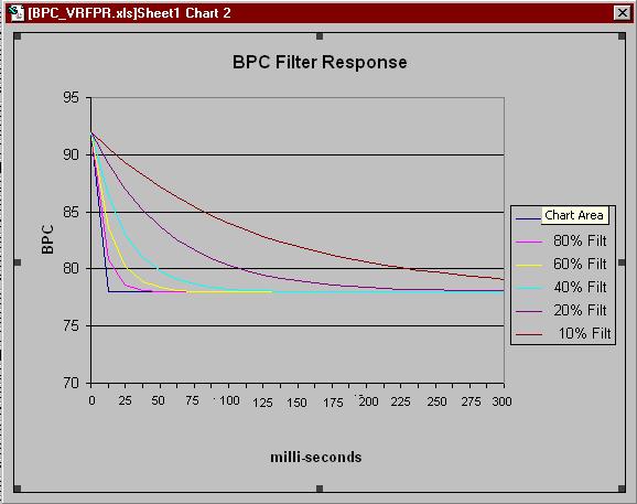

This is an interesting thread as it sheds some light on the response time of the Aeromotive FPR. Not sure what to think of the GM marine style regulator.
To better understand how the BPC changes and the resulting PW changes I put some graphs together. This is from an actual calibration that is being used. The graphs show a step response from 60 KPa to 90 KPa at 2,400 RPM (for the VE% values).
A step response was used as it is easy to calculate for. And it shows the BPC & PW values without having a sloped MAP value thrown in.
The first graph is the BPC vs Time (each tic mark is 12.5 milli-seconds) with various filter values. The 100% value is no filter action. The BPC follows the vacuum. The 300 milli-second mark is 3 tenths of a second.
At the same time the driver hit the pedal and the MAP went from 60 to 90 KPa, the fuel pressure regulator also started to increase the fuel pressure. The ideal situation is to have the BPC value follow the increase in fuel pressure one for one. If there is a difference between the two, then the fueling will be under or over.
In the second graph the PW is plotted vs time. Note the blue line for the 100% filter. The PW goes from 2.1 ms to 3.4 ms in one tic (12.5 ms). If the fuel pressure changes at the same rate then this is an ideal filter value (100%).
Then as the filter value gets smaller the PW peaks higher. This is going to add fuel as the filter values decreases. And the opposite, the fuel will decrease as the filter value increases.
RBob.

Even if the BPC filter were off a bit, couldn't it be compensated for with the VE tables (to a degree)?
There along with the AE tables. A too slow a BPC filter will cause additional fuel to be injected. This is while the throttle is opening or the engine load increases.
