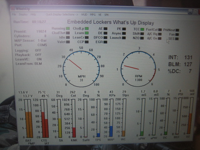

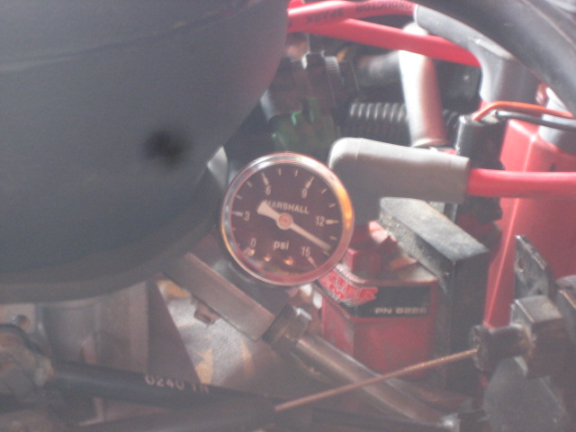

Allright, here it goes. FP is now 14 PSI, new BPC is 88. Lets see what happens. Checking the FP with a BPC of 95 and BLM of 128 for the most part=11 psi (stock regulator). AFPR is on now, 14 psi. Got a feeling it's gonna run real rich. Is there anything else I should change immediately with a FP change?

Results- after running rich across the board with 88- changed to 83 and VE is stable at 14 psi with a BPC of 83. here's couple pics
