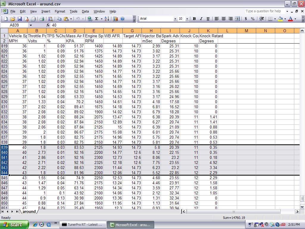

Why do I get a knock count when throttle lift?
I'm not sure why I'm getting these, usually 1 knock count when the throttle is lifted slightly after a punch. I've been able to rid most of the single knocks I got under tip-in by richening the AE in places. Now I'm getting this. I wasn't able to run over 21 degrees of SA WOT before but I've worked up to 30 now, but usually get a count or two.
Vortecs, BTW, hence 30* wot.
There are two showing in the log, seperate occasions.
Thanks,
Ben

MAYBE this doesnt apply to your case, but i was getting false knocks alot at what seem to be at accell, lift.------- had to put a 89 350 van knock sensor in as they were false.---now mine are gone.
