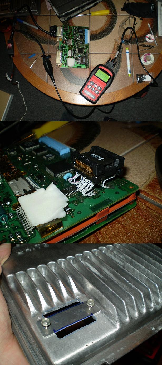

Wow... Been a while since I posted in this thread. Have to read the new posts and digest them.
Anyway. The new engine is on the stand and heading for completion, so Im trying to get the last of the essentials wrapped up. Currently, Im working through the idle routines. Much to my surprise (and relief), the idle algorithm is essentially identical to the $0D, so Ive been able to just use the $0D to comment the 98 stuff. The really nice part is that I'll be able to recycle all of my idle PID tables from the $0D and have 90% of my idle tuning done ahead of time.
I've decided to just cut a hole in the cover and socket the PCM and use my PP-II to tune. I have all the info needed on the OBD-II side to write software to scan and flash, but I dont have the time (or the knowhow) to write the PC software to do it.
Now that the PCM is almost done, I get to start the fun part of the build. Right now the car is basically just a unibody frame with a windshild and two doors. A year ago, I stripped it down to fix some collision damage, and devised a labeling system for all the parts and fasteners, which I promptly forgot. Now its sort of like putting together a big, greasy puzzle with 10,000 pieces.
If you want a sneak peak of the hack, Ive attached it. The engine code is not done yet (no comments on the EGR or O2 PID), but its getting there. There is also no e-trans code commented as Im running a stick. You will need to use the trial version of winzip 12 as the standard windows compression could not compress the .asm down far enough.

WHHEEEEE!!! Fun with soldering!
Got around to socketing the PCM. I decided to use an externally mounted spring loaded ZIF socket. Press down on the outer frame, and the chip easily goes in and comes out. Im going to mount it on teh outside of the case for easy access. Real PITA to solder it, though. had to use 44 little 30 AWG wires to hook it up, along with a lot of patience.
The PCM seems to work with it and doesnt bomb out or throw a bad checksum. Hard to say how it will actually work as I can only run it for a few minutes before the voltage regulator overheats (thing with the paper towel on it).
I found that the commercially available 29F400 chips actually dont have the annoying +12 volt write protect on them (never could find the source to unlock the chip). If they work, then I can just replace them and open teh possibility to being able to flash teh PCM. The code on the PCM side is (relatively) easy, but I dont know how to do much with C++, so I have to hit the books and figure out how to write an easy interface to transfer a bin from the PC to the PCM. Really, all it comes down to is erasing a block or two in teh calibration section and re-writing that with updated calibration data. Most of the routines needed are already given in the PCM within the kernal's OBD-II interface.
Attached Thumbnails Any coding/development being done with the OBD-II stuff?-pic1.jpg

So the part that you're trying to figure out, as in how to send a bin to the PCM, would be like checksun disable in the OBD1 ECMs, or are you talking about through the ALDL port?
Socketing would allow the use of an emulator, correct?

The main thing about socketing is that I can use TunerPro and my PP-II to program the computer, so I wont be restricted by the limited number of items typically defined within the commercial tuning packages. The downside is that its time consuming and inconvenient to use the pocket programmer to tune. That, and any static discharge to the chip or the exposed socket would be instantly fatal to the PCM.
It may be possible to adapt the roadrunner system to the black box PCM and use TunerCATS OBD-II RT tuner and VDF editor to allow me to make a full featured definition file, but the overall cost is too prohibitive. Its a shame that they sold the base OBD-II tuner to Junk Performance. I loved the original TC and it would have been nice to have a user configurable tuning package that could simply reflash the PCM. Ive requested the same feature for HPTuners, but it seems to have fallen on deaf ears.
What I would ultimatly like to do is to make a simple PC utility to automatically handle the uploading of a memory resident program to the PCM that would allow me to export either a whole bin or just a calibration sector from TunerPro to the PCM. This would allow me to use TunerPro to edit the bin, and then just upload the new section to the PCM. This would allow the use of a standard PCM without having to have any extra appendages hanging off of it, but I dont have enough knowhow on the PC side of things to do it.
