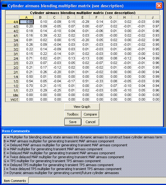

Heres a snapshot of the blending matrix. This probably isn't defined in such packages as HP Tuners, but it should be. The table only represents a portion of the logic as there are also other routines to handle applying the MAF and so fourth. This probably works well on stock engines, but if you have something thats a long way off, its probably best just to go straight SD or MAF and skip the headaches. I dont even know how you would tune this on the street or a dyno. It not only handles how the current fuel mas is applied, but what percentage of the fueling is the steady state airmass, MAF airmass, transient MAF/MAP/TPS airmass, and dynamic airmass. The numbers on teh side represent which quadrant the MAP and RPMs are in. The letters are the multipliers. In addition, you also have to be careful that the multipliers add up to unity, or the long term fueling will gradually head to full rich or lean.
