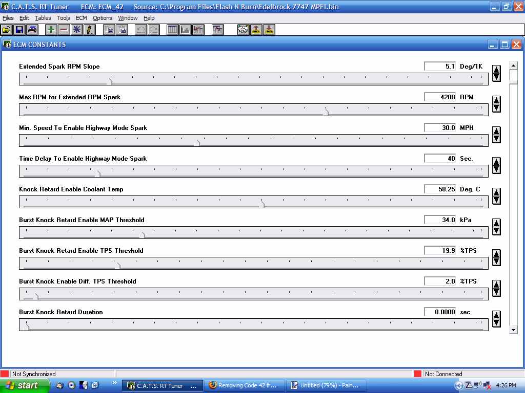

cant you just uncheck the flag for ESC so as to disable the ability to set the CE light?
Old Dec 23, 2008 | 06:23 PM
dave w's Avatar
Joined: Nov 2008
Posts: 167
Re: Removing Code 42 from ECM
I agree, unchecking the Err 42 in the ECM switch table will work. I would program a new PROM chip with the Err 42 unchecked. I might also make changes in the ECM constants table.
dave w
Attached Thumbnails Removing Code 42 from ECM-error-code-42.jpg   Removing Code 42 from ECM-error-code-42-02.jpg
