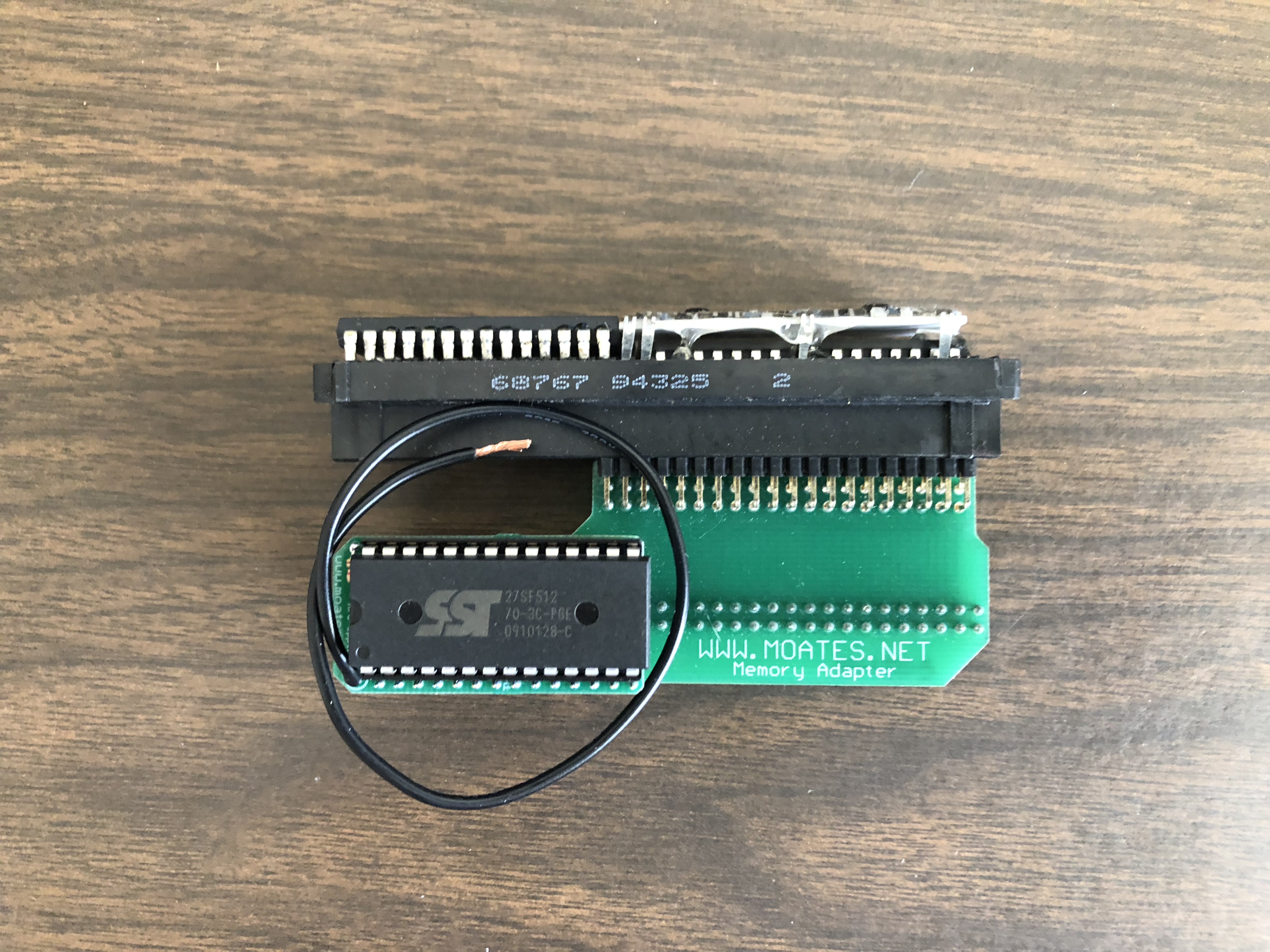

This morning I programmed a Moates.net Two Timer. I created 2 programs 256 in size and burned them both to a single 512 chip using different Hex address's. When this wire is grounded he will have 6 less degrees at wide open throttle when spraying Nitrous in the engine. The car will operate completely normal until it is grounded and sprayed.
