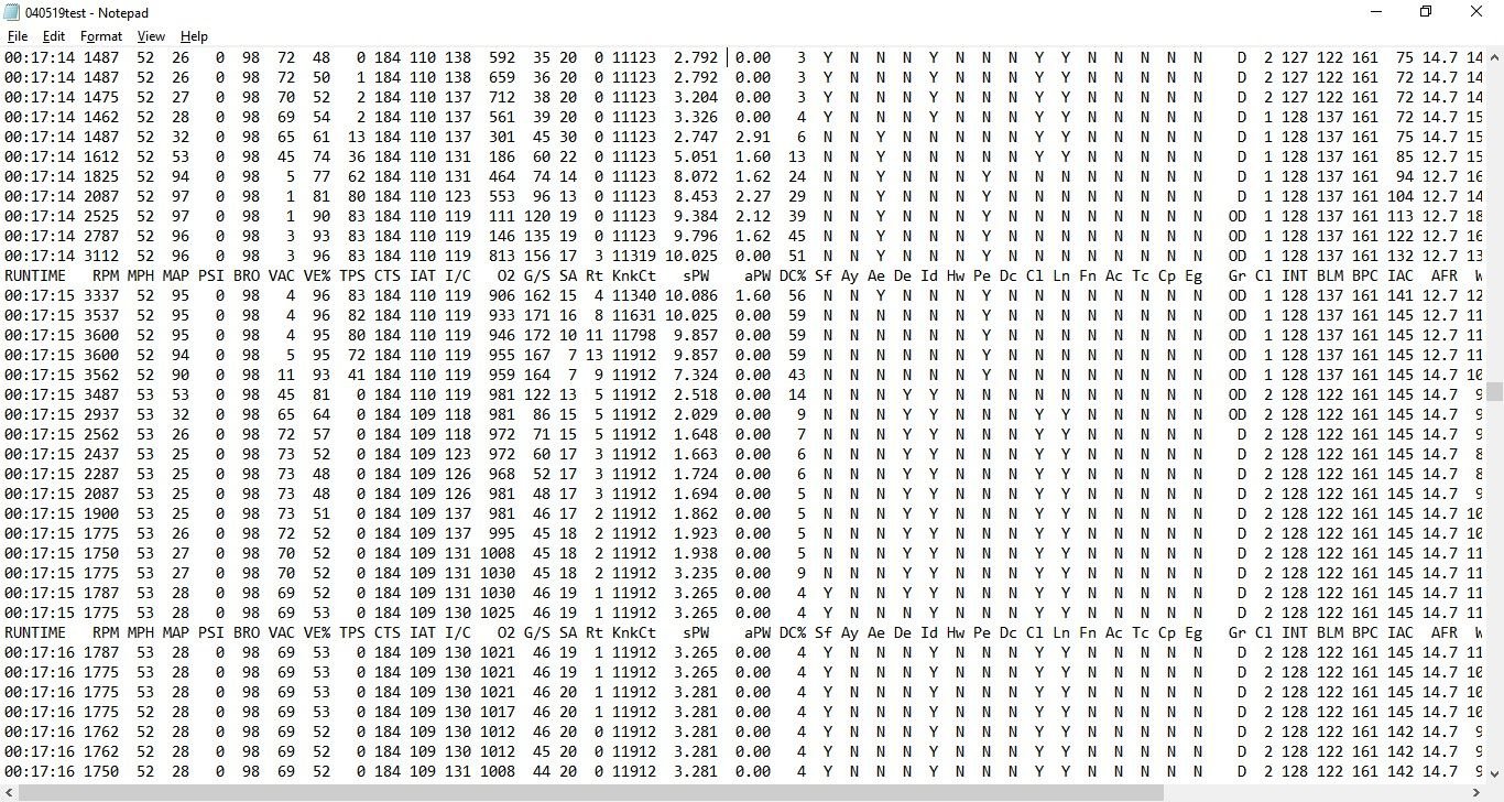

Here's an updated log file, and a screen shot of an area around 3600 rpm, 95 MAP where the retard hit 13 degrees (reduced down to 7 degrees SA). When it does this you can feel the power loss. AFR is at 12.7 commanded, wideband says it's closer to 11.5
Anyone have suggestions?
