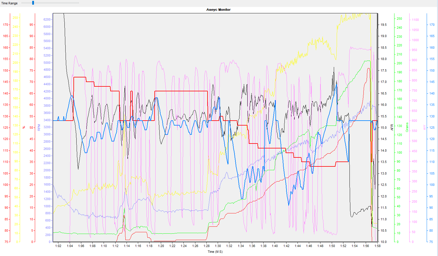

Using my datalog and some monitor charts, I can see that during closed loop anywhere below 120 Airflow is all running at 16AFR irrespective of which RPM I am in. In this datalog I was between 800 till 3600RPM.
That is all until I hit 60% throttle and 210LV after which AFR go suddenly down to 12.8AFR which I think is a good number for WOT.
You can see the graph attached showing the sharp drop in AFR with %TPS, LV8 (Yellow), RPM and Airflow.
Does this mean I have to try increasing all values in the first 4x MAF tables?

You're actually lean everywhere compared to stock. A stock $6E would be about 10.8:1 at WOT. Not that 12.8 is particularly problematic - I would be aiming for about 12.5 myself. But with the ugly lean tip-in and ultra-lean cruise you may go into PE with a very hot cylinder and that will promote detonation.

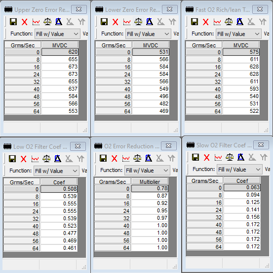

Was looking at an article about the 7730 ECM related to AIR Diverter where the ECU subtracts 100mV from the O2 to compensate for the additional diverted air in the exhaust when AIR is activated. If the AIR pump and diverter valves have been removed (as also is my case), the engine will run lean as the 100mV would still be decreased from the O2 readings.
The problem is that I couldnt find a similar article for 6E on 165 ECM to make sure that AIR does not kick in or to stop the ECM from applying the 100mV decrease in O2.
Could this be the reason why I am running lean while in closed loop?
I also removed EGR (Block off plate) but that aspect I handled it by doing the below changes in the PROM:
EGR Enable if TPS > X & EGR Duty Cycle!=0 changed from 5.86 %TPS (0x0F) to 99.61 %TPS (0xFF).
EGR Enable if TPS > X & EGR Duty Cycle=0 changed from 6.25 %TPS (0x10) to 99.61 %TPS (0xFF).
Disable EGR if MAT < X changed from 0.50 Deg F (0x1E) to 304.25 Deg F (0xFF).

Disable egr if mat is less than 304 will disable egr
o2 milivolt values will control target swing/switch point for closed loop so it may want to correct for a leaner condition. You can change the o2’s around in the expanded 6e xdf
i think its called diff value to make up rich lean when divert air. Set to 0.102 v. Change that to 0
you could also try the fast and slow rich lean o2 mv offsets vs airflow. Might help some

Will try LC454. Its called 'Difference Value for Rich/Lean Window when Air Div. Currently set to 0.102Mvdc. Will set this to 0.
I will then do another datalog without touching MAF tables and let you know if it affected anything.

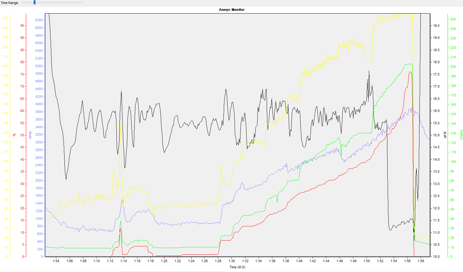

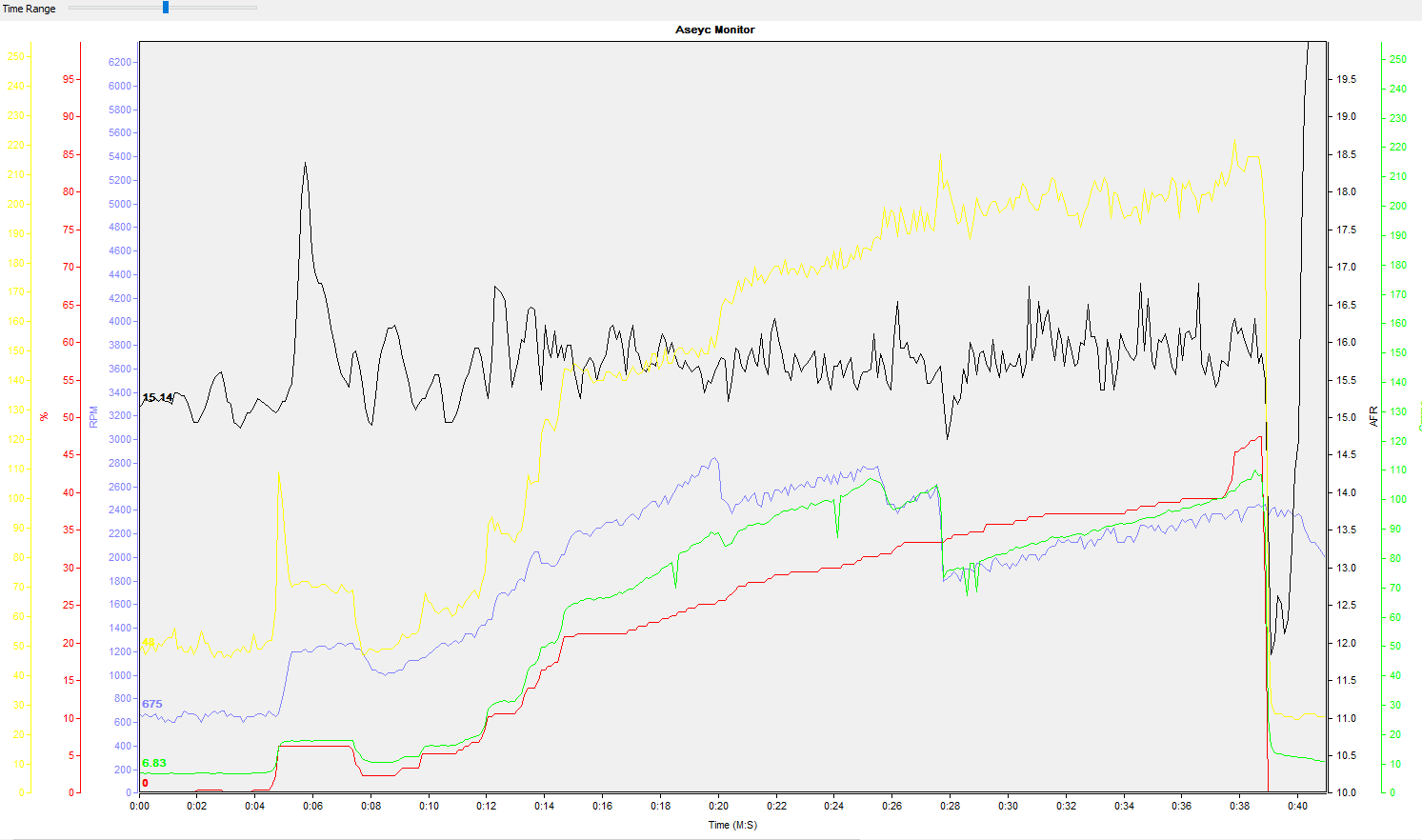

Went to test it today at the airstrip. The change on the AIR divert (increasing temp to max and removing the 100mV offset) did not produce any changes whatsoever.
I then tried modifying the MAF tables in steps of 5% until 15% and I honestly cant see any considerable differences in AFR. It might have increase a bit the power although I am not 100% sure. It surged a bit at a certain point but it was only for a couple of seconds. What is worrying me is that AFR is still swinging in the 15.5 - 16 regions no matter the changes I am doing.
I think it is fair to assume that fuel pump, filter and / or injectors are fine as when the necessary variables reach a situation for WOT (I think LV8 at more than 200 and TPS at more than 70%), the AFR goes down to 11.5. When engine is open loop, AFR is also fine as it would be around 13.5 - 14. Seems like some parameter in closed loop is forcing the ECM to supply less fuel.
You can see graphs for one of the runs while I was at 15% increase across all MAF tables.
This is with 15% increase across all 6x MAF tables
This is stock ARAP with the AIR modification
Do you guys have any recommendations re this issue?

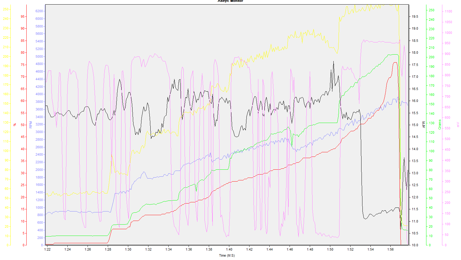

Would it make sense to use my Wideband's simulated Narrowband signal in place of the stock non-heated O2 sensor? I am exploring this as I am running headers and the factory O2 might not be ideal for such a setup.
Anyone have experiences with using a simulated NB signal from a WB?

Plotting the NB voltage, for sure I can notice that it is in line with the WB signal just the inverse of it as apparently NB voltage goes high for rich and low for lean. So as far as functionality and realistic view, the NB seems to be reading fine when compared to the WB. Voltage swings between 50mV to 950mV (Purple line on graph).
Black = WB AFR, Purple = NB Volts

Something is not right about the correlation of the WB and NB sensor values. They should cross each other at about 14.7 for the WB and 450 mV on the NB. At the time of crossover the WB is reporting lean and the NB is reporting rich.

BLM tries to follow INT and INT is in the regions of 105 when the AFR reads leanest. I dont have access to my PC now as I would have sent the monitor with BLM and INT plotted... will do so as soon as I go back home.
With regards to where NB and WB cross eachother I would guess that sampling time between the two would skew where they intersect?
I also didnt know that MAF tables affect only Open Loop. To be honest I noticed it was a bit richer during open loop.

Attaching below the same run with BLM and INT graphing.
Note BLM and INT are frozen at 128 during WOT. As for the rest they swing between 110 and 148 with INT going down even to the regions of 90 while AFR swings in the regions of 16 - 16.5...
Airflow, RPM and TPS all follow a steady climb.
BLM = Thick Red, INT = Thick Blue, AFR = Black, NB Volts = Purple, Yellow = LV8

To be honest I tried searching all over the net on what the O2 tables are but didnt manage to.
There are the following table in $6E ARAP and I cant figure our what to change:
1 Upper Zero Error Ref for Slow O2 Rich/Lean
2 Lower Zero Error Ref for Slow O2 Rich/Lean
3 Fast O2 Rich/Lean threshold vs Airflow
4 Low O2 Filter Coeff vs Airflow
5 O2 Error reduction Gain vs Airflow
6 Slow O2 filter CoEff vs Airflow
See Attachment. Dont know what Fast / Slow mean in the first place. Is it related to before its reaches the proper temperature or not?

Not sure what is causing your issue as i havent seen a stock code target that lean at part throttle
are you sure the sensor is reading accurately and no air leaks in the exhaust that could be skewing data?
if no leaks i would try maybe adding 100 mv to the top 3 tables you have posted. See if that does anything. Or atleast to the grans sec values where you are lean.

The problem is that the grams / sec values only go up to 64 in those tables. Thats what I cant make sense of. I am lean across all airflow range.

Still worth a shot. Im not sure if they hold the last value for grams above 64 or if it stops using it

Went for a run today. Decided to load the MAF Scalars, MAF tables and related INT and BLM Tables / Scalars from an AUJM. The reason for this is that I noticed that AUJM has higher numbers in its MAF tables for Voltage vs Airflow thus it made sense to me that it should run richer albeit lately I learned that MAF tables are significant only in Open Loop. Anyway I gave it a shot but sadly enough it didnt really make any difference. To be honest I think that with the AUJM map, OL is a bit leaner even though MAF tables have higher values...Granted Scalars are also different thus it might be the reason for this. Closed loop still in the regions of 15.5 to 16.5 AFR.
So I then decided to fiddle around with O2 tables as suggested by Orr89RocZ starting with Upper Zero Error Ref for Slow O2 Rich/Lean changed. Increased by 5% > no change, increased by another 5% > no change, another 5% > no change. Total of 15% overall without any effect.
I then increased Lower Zero Error Ref For Slow O2 Rich/Lean changed by 10% in two steps but still again no noticeable change.
Increasing also Fast O2 Rich/lean Treshold vs Air Flow by 10% didnt result in any difference.
None of the O2 tables enriched or en-leaned AFR... The ONLY time that I see a decent AFR of 12.5 is when Airflow exceeds 130 grams and TPS is around 55 - 60%, LV8 around 220. I am assuming this condition results in WOT.
