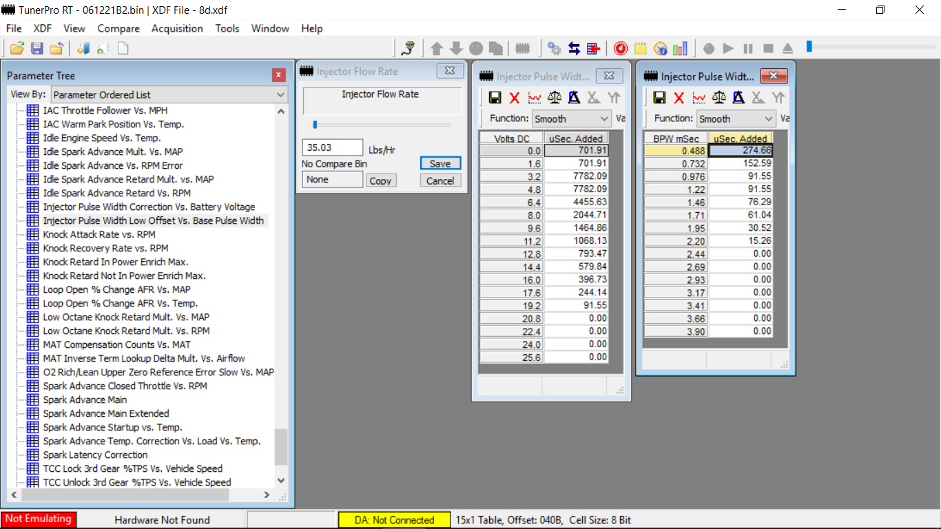

His injector flow rate also needs to be increased from 35% to 36%. The upper VE table needs to be put back to where you had it, you're taking too much fuel out after 1600-RPM. Upload that Injector Offset table that came with the Injectors whenever you can...

Here's a quick pic of the Bin, correct the Injector Flow from 35# to 36# just to get that out of the way, then confirm that the offset values are correct in the 3.2 and 4.8 range by uploading the offset doc, they seem very excessive in that area...
- Rob

I don't have the offset values. The injectors came from Southbay. When I looked up the injector number it corresponded to a Volvo 35lb injector. That's why I put 35 as the constant. I did try go up to 38 but again, no change. I copied the Injector pw correction from 350tpi I thought. But now it's a little off.

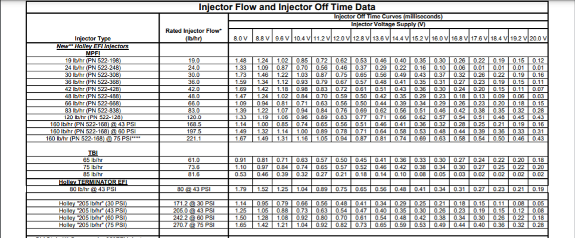

Somebody in the comments section of the link you provided mentioned they used the Holley 36# offsets with success, and that the idle was very good with those injectors. Here are the Holley 36# offsets, see below. Not sure what to make of the 3.2 and 4.8 values found in your Bin, however they do match the $8D offsets from what I can see. I would try lowering those two though, make them match the 6.4 volt area, while leaving the 0.0 and 1.6 volt area alone. Just my two cents...
