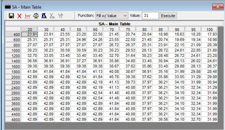

Larry - Would you share your spark map with me please? Or your bin and mask?

[QUOTE=BCCHowdy;6483972]Larry - Would you share your spark map with me please? Or your bin and mask?
I am using, GM fastburn heads and hotcam, 10.25cr
