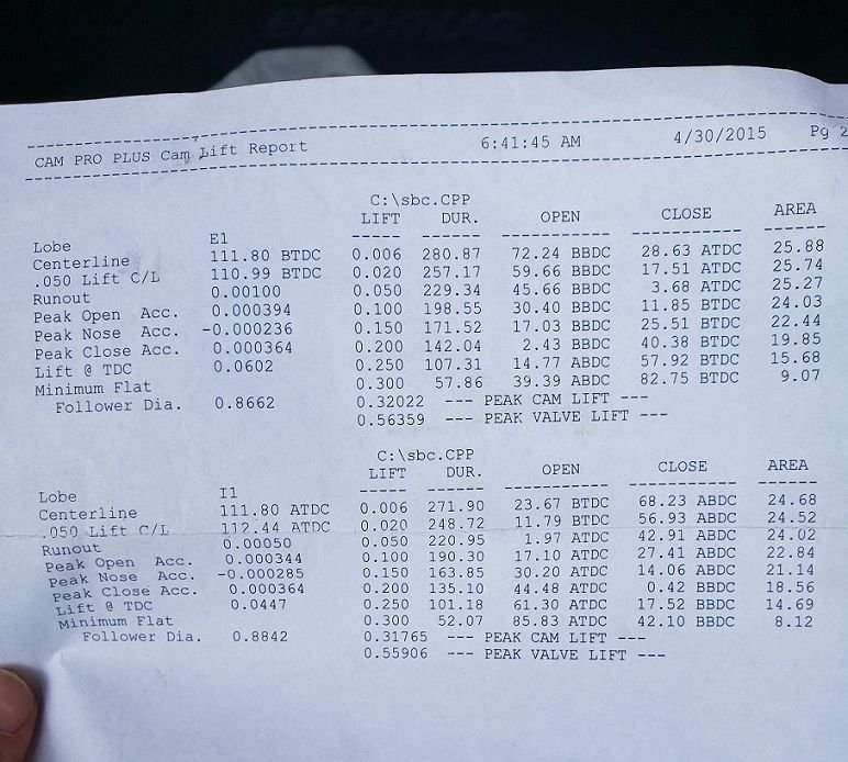

So let me start off by saying, I tried the best I could to tune the car based on researching everything I could on the forums here before I started to post this and what bits of knowledge I had from using HPTuners in the past. But at this point I'm just stumped and not sure what to do. Like the dozens of posts on here, I think I am having issues with the IAC motor and tuning. The issue as many have had on here, is the transition from Park to Drive gears. While in Drive or Reverse, the car stalls while idling after a few seconds in gear. I have a 1988 Trans Am GTA, rebuilt 350, and 2200 (I think...forgot) stall.
The 350 has aluminum heads, factory TPI (not ported), cam (specs below), new pistons, rods, etc but at factory compression. I have replaced the IAC motor, replaced the Narrowand O2 sensor with a 90-92 spec sensor (car didn't seem to want to go into closed loop without changing this), using an AC Delco MAP sensor from GM, and converted the car to the EBL P4 PCM. Before the PCM conversion, the car did stall on occasion but not nearly at the frequency it does now. Before trying to make any adjustments myself, I started by loading in the EBL_P4_3005.BIN as I wasn't sure what the EBL P4 came stock with loaded in the PCM, and the readme text file says the 3005 binary is for 350s with Automatics.
