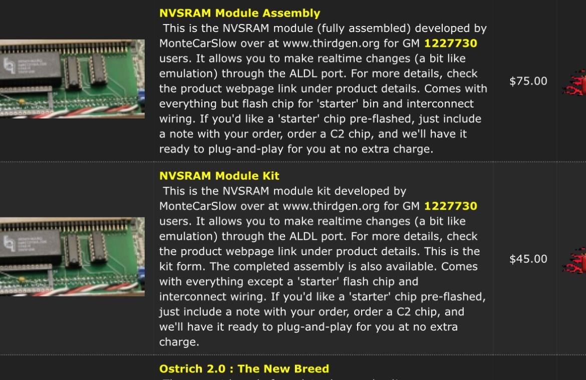

The Nice part about $12p is you can flash the code through the aldl link like an emulator. This takes an add on board but add the ability for wideband integration. They use the same type nvram that monicarslo used on the 7730 that very few used. S_AUJP Version 7 can do the same thing if you have the hardware for it.

So cool, I have a few of the nvsram assembly’s I need to use .

It's a shame they didn't become more popular as they make tuning a lot easier.

I bet, I built a kit from moates years ago then found a ecm with it installed.
I think the moates pcb and supplies was only $45not a bad deal.
http://static.moates.net/nvsram/Site...tructions.html
