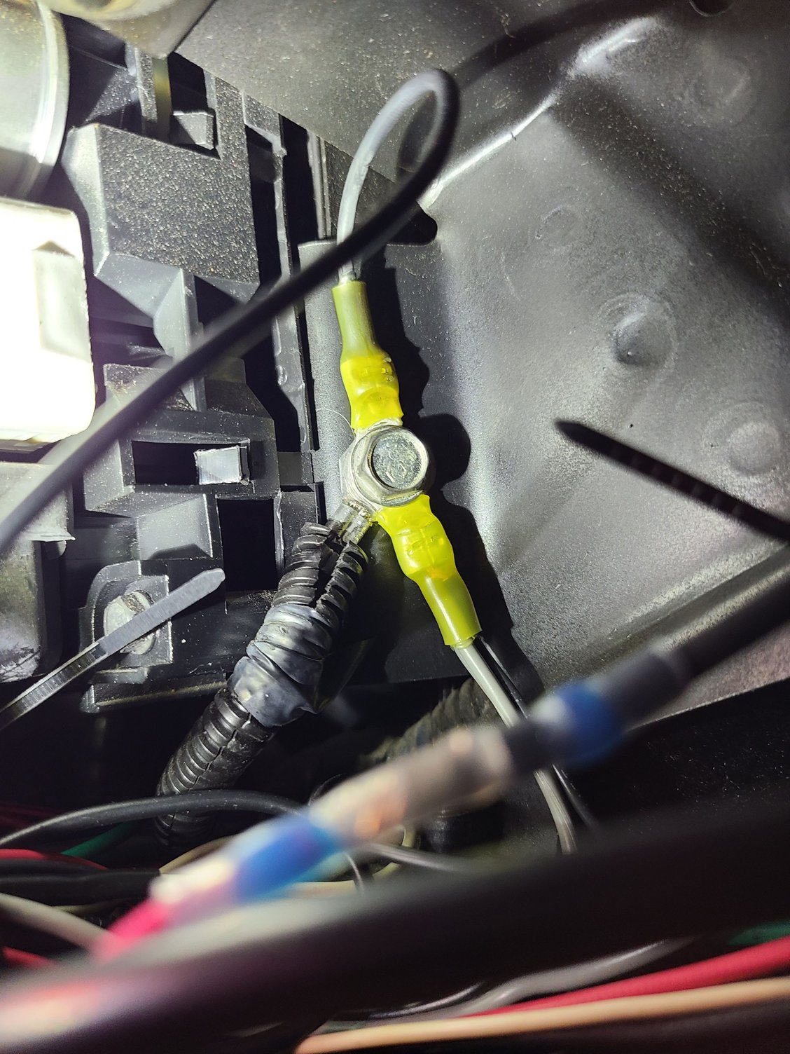

Originally Posted by raptere
so, I've got all my details transfered over to the S_AUJP bin, and have the other two files loaded and working.
I got the IAT wired, but couldn't find a 3/8" tap locally so I'll have to wait for one from Amazon tomorrow.
now I'm trying to wire the white 0-5 V wire from my WB to my ecu. I recieved the connectors from ebay. You say I need to connect it to one of the ecu connectors in position F14. I see numbers on each connector, and letters, bit I'm not seeing an F. Can ypu give me any hints on how to identify the right position on the right connector?
You say the ground also needs to be excellent, it's one of the three twisted, crimped, and shrink wrapped wires in this connector. Bolted to one of the factory under dash grounding locations on the driver's side. Good enough?
I know I’m a month late but just below this thread is a tunerpro xdf that will modify your $8d to log both pins and more.
