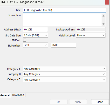

If you mean the hex address, I see 0x1DE in TP....

Oops..I misread it. I'm not seeing that in TP actually for $32B... and I don't have $32B in TC unfortunately.

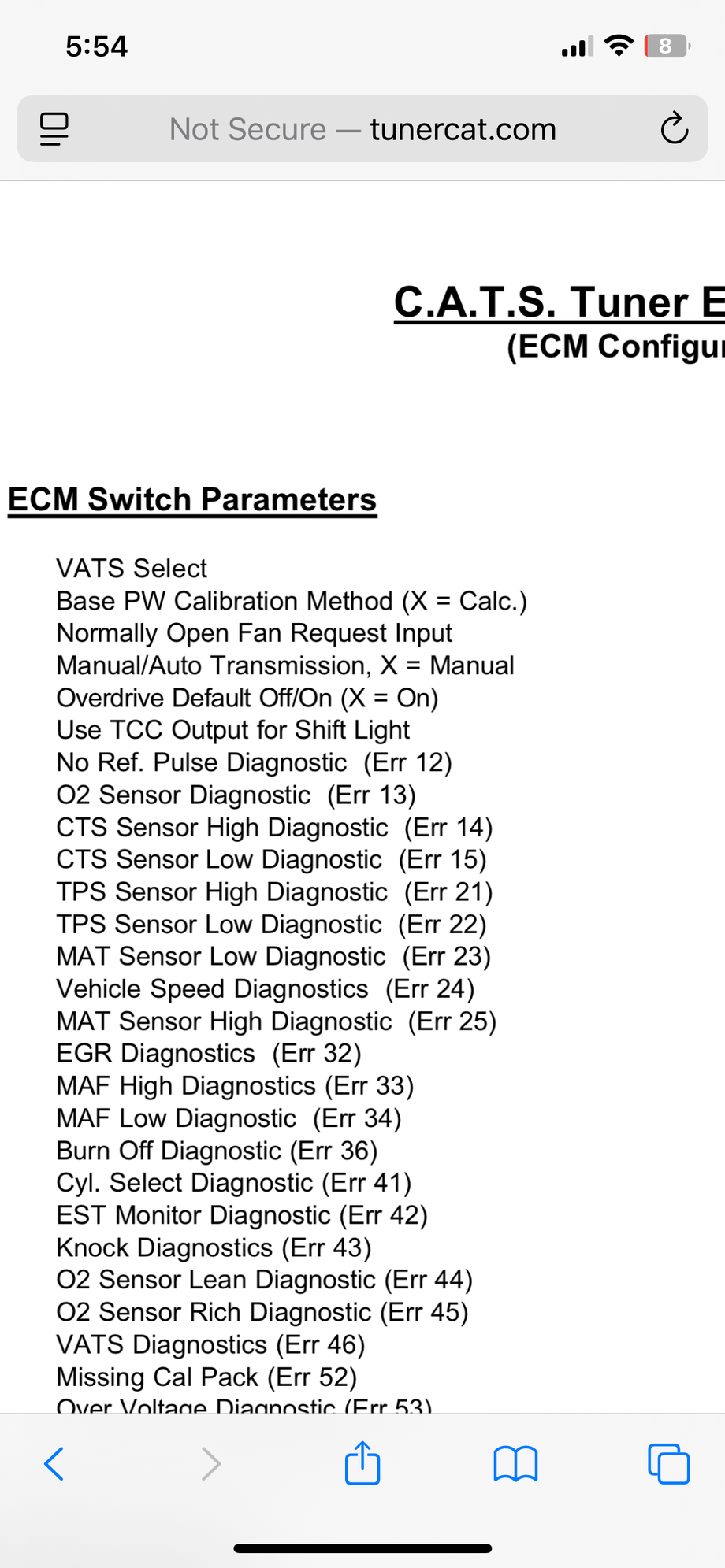

I tried to see where $6e changes the code with a modified bin with tuner cat. It just changed checksum. But tc site shows the $32 they offer can disable 36 in $32 mask.
