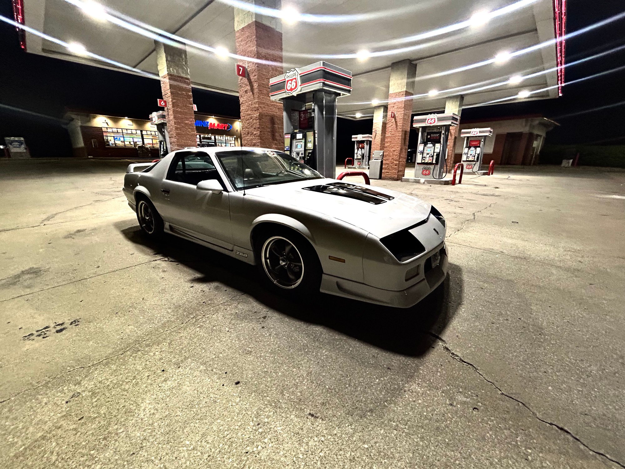

This is my 1991 z28 5.7 Camaro, having trouble with diagnosing the problem.
I was at a stop light on the way to school and heard it get a little choppy like it was running on 7 cylinders i pulled into the gas station and noticed it was starting to get worse to the point it would stall if i put it into gear, so i got it towed home. I found a couple vacuum leaks and replaced the idle control valve and even relearned it and checked the codes and no check engine light. it still runs like ****, curious on if you guys have any suggestions on what to do next
