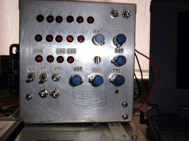

Mines pretty much built in a ecm case.
I just used some 55s for the rpm and vss.
Also went nuts and used flip-flops so the they were 50% duty cycles.
Dats the one part that's lasted forever, and I've lost the skematics for em. If you posted to GMECM I'm sure one of the EEs would give ya a hand.
May 25+26
On the 24th gonna convoy over to Mendelsons, dunno what time on that yet.
On this version I'm just running leds, instead of injectors, if you want to run injectors you really need to use a Tractor battery to have the amps and then run a trickle chagrer when your firing injectors.

The point is to be able to watch changes you make in an eprom before you take your 1.5 ton vehicle on the road. One thing I hated doing was making some changes, taking it out on the road and having it hesitate really bad, sometimes it would even stall in extream situations. Also if (not likely when) you do source code / assembly coding you never know what'll happen and it's always a good idea to check things out. For example, I want to program my ecm to control my fan. I hope to eventually have the fan parameters as such; coolant on and off temp, vehicle speed on and off. So when the car is running down the highway at 55+mph the fan turns off and just spins. I'm also planing on going to a cowl hood mid summer and I think it would be cool to have a speed dependant cowl flap. It won't be a problem so long as I get some time to tinker with this stuff.
Basically you can watch what a car would do without actually leaving moving your butt .
Grumpy, how are you displaying the timing?

In my ecm I've found some stuff that's not even in the code they have settings for.
You can see how the commanded AFRs change when you make a change rather then have to make a WOT pass. Once you see how the commanded AFR and actual line up then you can pretty well predict what to do where to get what result.
You can monitor the duty cycle of the injectors at any and all points of the table. Rather then having to sort thru datalogging.
An ecm bench is like a WB.
You don't have to have it.
But, they make GREAT TOOLs for getting the system right.
and this is all just about the oem code, changing anything takes you to a whole new level of tuning.

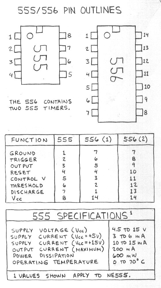

I have an old radio shack engineers notebook on 555 timers, I copied these 2 parts out that ought to help, one is a graph giving figures on what capacitor and resistance values to acheive certain frequencies, with the right pot, you can get the frequency to change. Since the distributor turns half as fast as the crank and you want one ossicilation per spark, you would need the frequency to be 4 * any given RPM for example at idle of 600 RPM you would need the frequency to be at 2400 Hz and up to 6000 RPM to be 24000 Hz.

got the pics backwards, but the last one is how the 555 timer is hooked up, and if you are needing to use 2 555 timers you can use one 556 chip which has 2 555 timers inside it and only needing one 5V input and one ground. Here is the chart that was supposed to go in the last post. Ill have to rescan it, the pic is too big to fit, Ill repost it here shortly

555 timer graph
not sure what the deal is but I cant post the pic, it keeps saying too large but its smaller than the allowed value, unless the server counts both pics together, but if anyone wants it email me at jpotvin@rap.midco.net and Ill send it to you

Ok..getting started on the bench. But still have a couple questions.
1. Can I Ohm my Knock sensor and replace with a resister to ground?
2. I don't remember seeing how the O2 was set up. Can I use a pot to swing from 0v to 1v?
3. Grumpy, any values for the pots? Heading to Mendleson's on Friday for parts.
I think I have the rest under control. Will post some pics as soon as something's ready, doing all the planning and getting the case prepped. Going to use a 165 case/connector and wire up with a pigtail to go between the ECM and bench. Going to include the aldl converter inside too. Lots of drilling and soldering ahead. cheers, Bob

Much cleaner, and now that it's specific to one ecm, I can do a full labotomy on it.
And with the Romulator, no chip buring.

When can I check it out? I'm only what, 1.5 hours away. My test bench is still in pieces. All the circuits have been made but it isn't organized. I'm one of those kinds of people that needs all or nothing. Since I didn't have all the same switchs or trim pots I just left it sit back in NJ. Every time I think I've got the time I end up wrenching on somebody's car. Someday when I take a break from school and get a job....

IM in, much easier to do this then hook up the battery each time i make changes.
