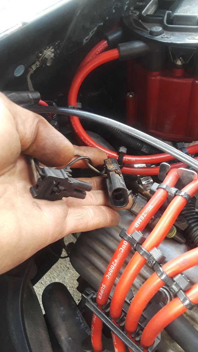

I just recently had a similar issue and was looking online for information and through a lot of these threads I ultimately track down what it was not exactly but at least the part that was causing the issue that corrected it. I have an 86 Trans Am and I swap a T5 in and in the process of doing all that I'm not sure if I messed with one of the wires or whatever but after going through each and every section of wire and connector unplugging and plugging back in and trying it , the one I did it to get get everything working again was two 2 wire connectors that come off from the same harness right next to the distributor and they plug into each other not sure what it was for but upon disconnecting that one and starting the car up everything worked again , and to make sure I ended up plugging it back in and tried starting it again and it poped the fuse and took out the gauges and set off Doug father for the key in the ignition. at least for me that's what worked. it's no longer popping the fuse and everything else is working as it should . As I said I'm not sure what that particular wire set is for I converted everything it from TPI to carburetion so I don't know if that was important for anything for the engine but at least that's what work for me if that helps anybody else. I just remembered that I read a few threads on here about others having issues so I figured I would jump back on the share my findings
