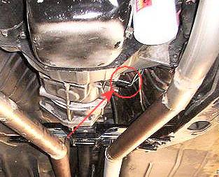

I believe the revese light switch on a T-5 is the one in the middle of the gear casing on the drivers side (not the one on the tailshaft). I know it's not under the console on the shifter itself.

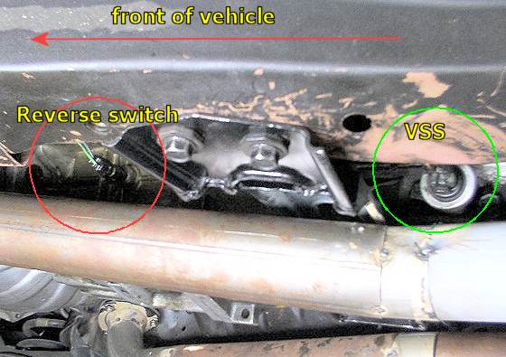

on the drivers side of my car, attached to the tranny, i located two things that look like long plastic cylinder pieces that go into the tranny. Sort of like the o2 sensor, and each have 2 wires coming out which go....i don't know where
would one of these be it?

Ok so the front one of the two is the reverse switch..
Is there way to test it to see if it's good or bad, if it's bad, do i just take it out and replace it or is it something hard to do?

put a multimeter on and set it to OHM and hook it up to each connection. nothing should happen when the car is not in reverse but when it should complete the circut and the ohm meter will go all the way up (depending on setting).
