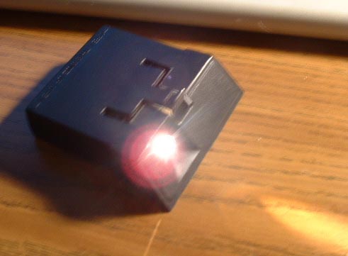

Ok I got it to work. I think maybe radio shack had a bad batch of bulbs or something. I cleaned it up even more and popped in a new bulb. Works like a charm. Let me tell you, that little bugger is bright! I had my doubts, but it definetly works great as a flashlight. Anyone who says otherwise...Ill bet you you cant stare right at it for more than 15 seconds without gettin a huge dot in your vision. Thanks for the help. Hopefully this is the last little thing I have to fix for awhile.
Justin
