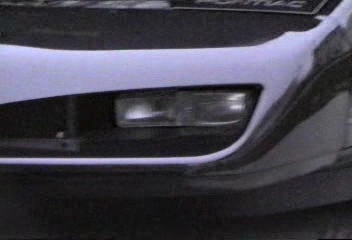

I bought a set of driving lights that look almost identical to the Trans Am fog lights from a parts store. Cost me I think 30 bucks and all the wiring and switch come with it (junkyard wanted 80 bucks for T/A foglights ). This is one add on I'm very pleased with, and the lights are wired so that they go on whenever the ignition is ON.
Sorry for the crappy quality:
Attached Thumbnails Trans am foglights addon to Firebird Formula-headlights-small-.jpg
