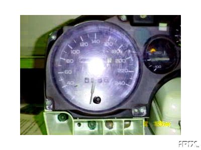

pic

Thanks guys, but I talked to a guy from terf.com (the guy really knows his ****) and he told me I could swap the standard Camaro guts in, than buy a recalibrator and be good to go. So once I buy the speedo (it comes w/ the whole cluster including a 7k tac.) I will get to work on it, than later this summer I can put it in the car. Only problem is the freakng thing will run me over $250, but hey most people dont even know they exist!
