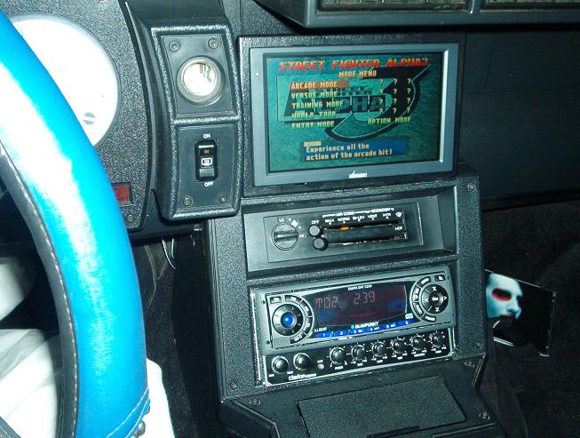

Someone on the board has this car...
Also you can just get a laptop and mount the screen on the dash, just lengthen the wires.

Whats left...oh the screen...or should I say Screens. I bought 2 sun visors with 7.2" TFT Monitors and a 7.2" Screen for the dash. so thats my battle plan for the video. The 7.2 TFT Sun Visors are only ran by Svideo however the 7.2" monitor is driven by an SVGA input with touch screen interface.
As for controlling it. I am currently writing a voice command system so I can just shout out my commands and the computer will recognize. I have it recognizing GPS, Winamp, Play, Stop, Next, Back, Shuffle. I am still working on getting it to calculate the ETA when I am on a trip and have it plot courses as well. I want to be able to say "Computer" which is what you say to activate the voice recog "plot a course" then it will say "enter destination" and I can reply "Bumsville Idaho" or whatever and it will plot the course. That is what I am working on now.

Thraxx, for your 7.2inch dash display, all of the itx boards ive seen have a built in vga connector, as for the touch screen, they are the same connector as a mouse uses, serial port or ps/2 port

the 7.2" dash mounted Display has 2 video inputs and a VGA input. The touch screen portion is a USB connector. I bought it off of Ebay for 300$.
The 2 visors won't be used for the computer. Gonna use one for the camera that I plan on mounting on the rear and the visor on the passenger side will be for the PS2 so they have something to do on long trips.
