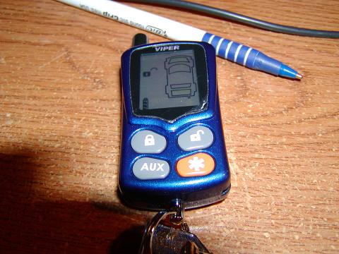

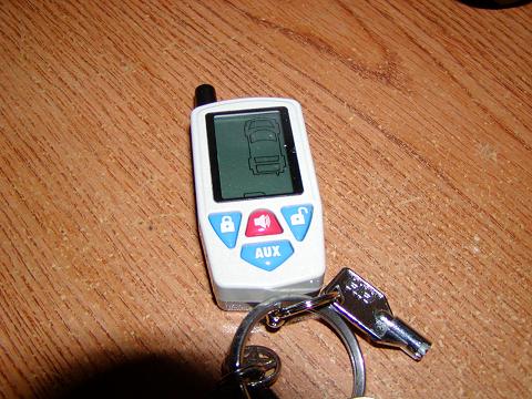

yea my remote has quit working like 3 times they just keep giving me a new one here are some pictures

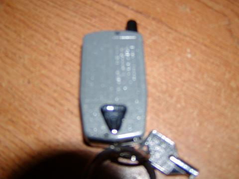

backside

are they replacing the alarm while you are there? or are they sending the unit in ? if they will not help you I work in a audio store and I install remote starts and alarms I can send it in for you( if needed)

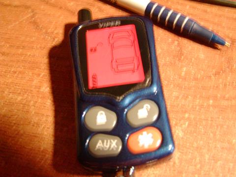

i went yesterday and they gave me a new alarm system free of charge
Old Feb 18, 2004 | 02:52 PM
RED92BIRD305's Avatar
Posts: 459
From: Toledo Ohio
Car: 92 firebird and 95 trans am
Engine: LO3 and LT1
Transmission: 700R4-4l60E
with a sweet orange backlight
