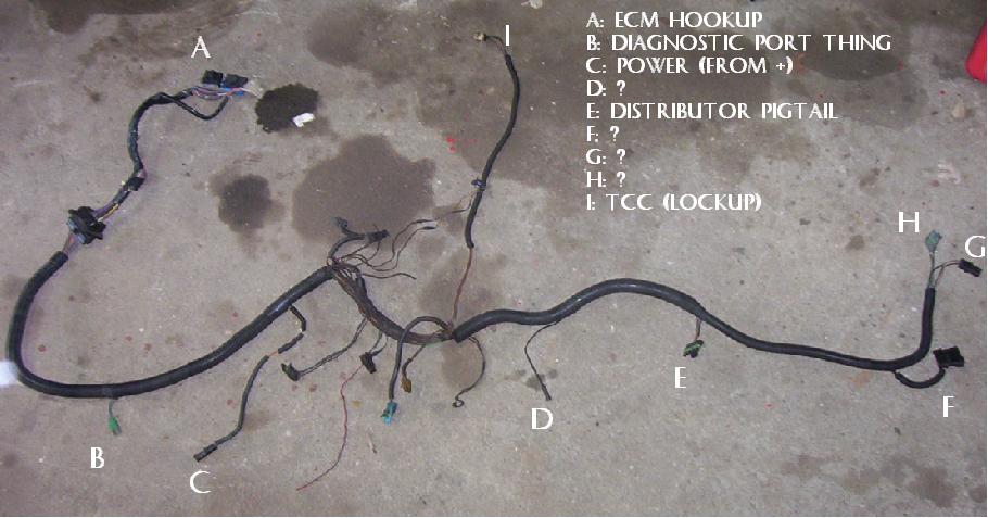

Name that wiring harness connector game!!!
Need some help with putting a label on some of these connectors for the computer wiring harness. The car's an '86 camaro LG4 (305 cc 4bbl) auto, a/c.
Attached Thumbnails Name that wiring harness connector game!!!-computerharness1.jpg

Zoomed in of center. This is where it gets ugly.... i can get some wire colors if needed. there are a couple wires that look to have been cut. let me know if you need closer views or what. Thanks for any help!!!!!
Attached Thumbnails Name that wiring harness connector game!!!-computerharness2.jpg

can you get closer pics of all the ? plugs, and label them the same, if I can see what they look like, I should be able to help

first picture
(B) not connected to anything
(D) vacuum source for map sensor
(F) est module
(G) goes to plug coming out of fierwall by brake booster
(H) map sensor
second picture
(A) & (B) to the carb
(C) baro sensor
(D) egr solonoid
(E) vacuum line for map sensor (to back of carb)
(F) maybe the coolant temp sensor for the ecm
(G) & (H) smog pump air injection diverter valve
don't hunt me down and kill me if I'M wrong

second pic
pink wire thats cut goes to the o2 sensor
the other two cut wire goes to ground by the alternator ( I THINK)
