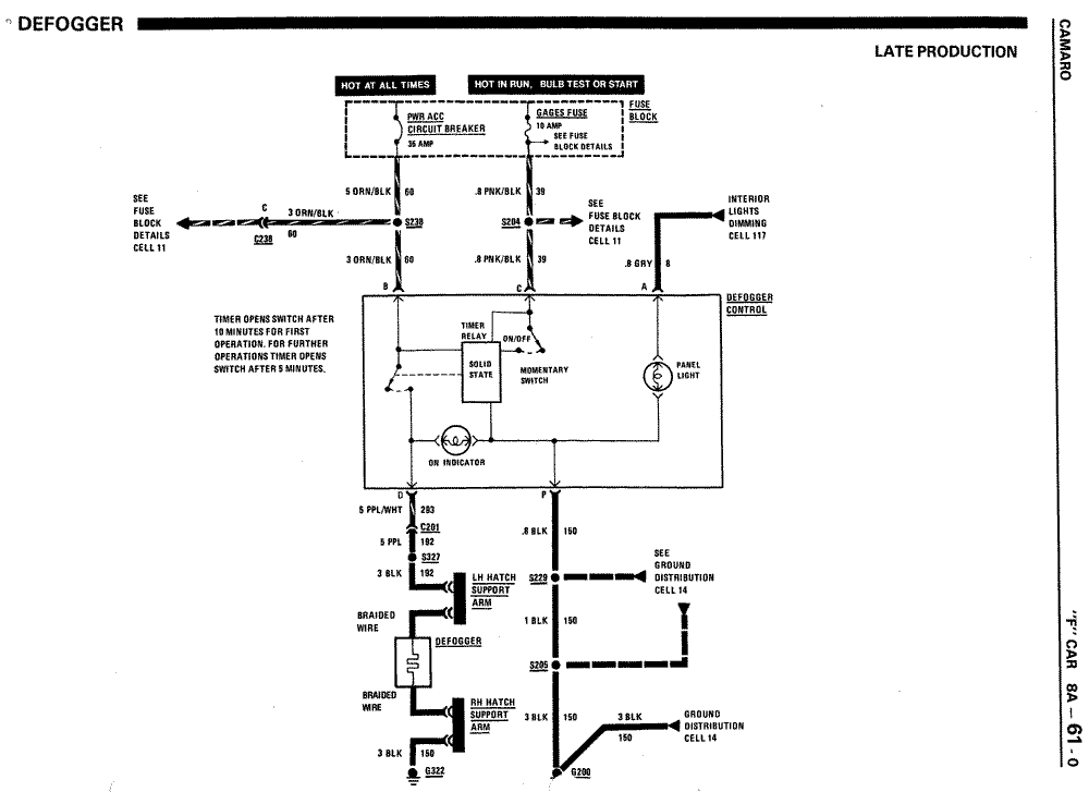

Here is the schematic for a '89 camaro, it should be basically the same on your car. There is not a seperate relay on ours for it.

so assuming i already have the wires for the defroster in the back and i got a switch, and i have a deforster hatch, it should just be plug and chug right ?

There is a seperate relay on the Firebirds that mounts behind the bolster trim at the bottom of the dash on the passenger side - not the hush panel, it's the long narrow one just above it. It's usually a silver metal case, about 1 by 1.5 by 3 inches. There may or may not already be a plug-in for it.
If you can find one in a parts car, part of the wiring should plug into a junction panel behind the drivers kick panel.
