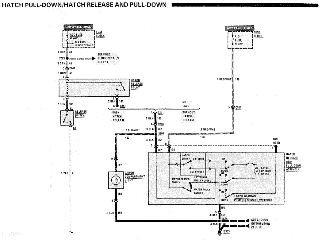

This is what i would like to call a screwed up situation.. The hatch release on my car is screwed. Its just a manual, but my gf's camaro (that she happened to roll last fall) has a electionic hatch release.. but it was never properly hooked up. She bought it and it was in there.. the guy just never went through the time to hook it up.. Does anyone know what i could to do wire it up correctly and for it to work? Thanx

Here are some schematics for you to look at and see if they help you.
Attached Thumbnails Electronic pulldown/ release-1ae.gif

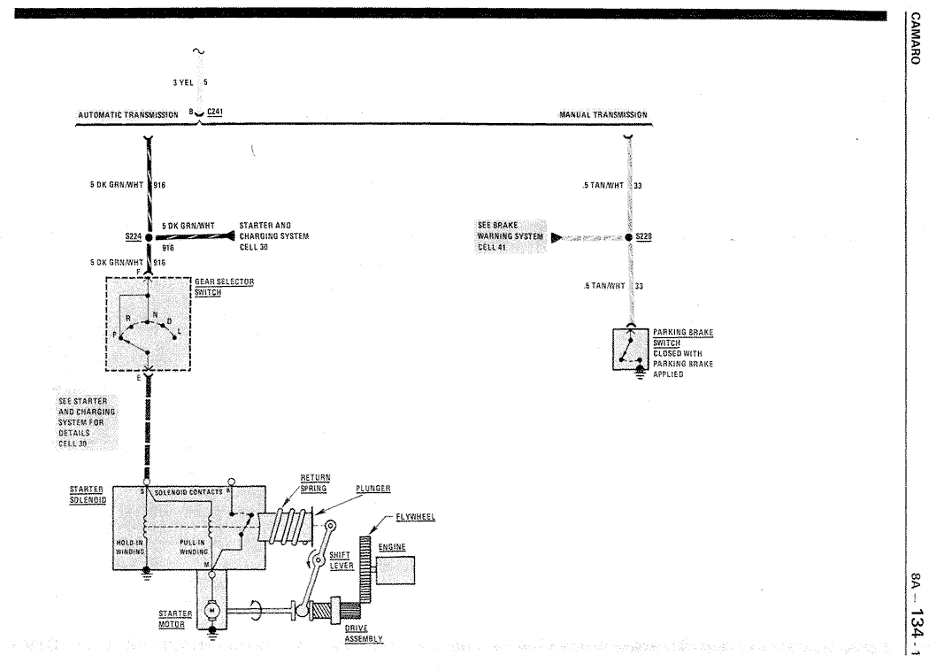

page 2
Attached Thumbnails Electronic pulldown/ release-1af.gif
