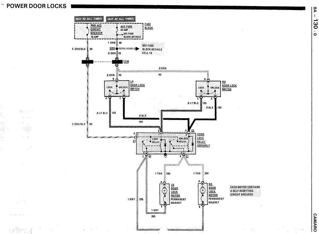

i just bought an 89 camaro RS, has power locks but they are not working, i think it might be the relay, but i'm not positive, any way to be sure, and what do you think it might be

Hello hotshotcamaro,
Here is a schematic of the power door locks and a few things to check. The two fuses in the schematic, battery power, and relays. Both fuses are in the fuse block, the PWR ACC fuse is one of the metal fuses.

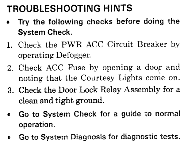

page 2

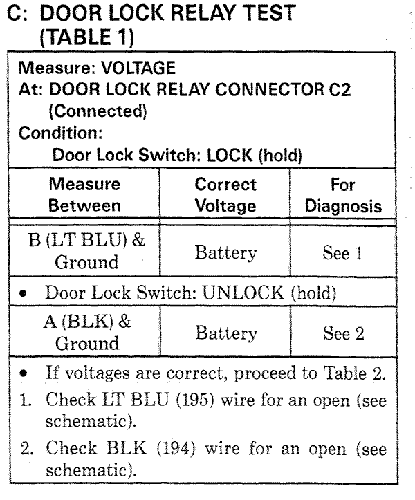

page 3

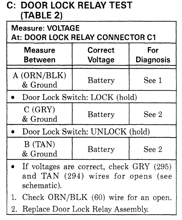

page 4

thank you very much trickster, now that i think about it its prob. the ACC because my courtousy light doesn't come on and neither will the rear view mirror lights, i thought they might have been burnt out, but they didn't look like it
