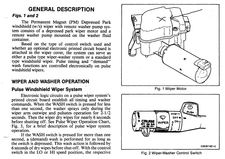

I was surfing some forums about tech stuff and more specific wiper motor problems because I have one got a brand new motor now and I want to make sure my module is good before I go through the time and MONEY to put in a new wiper switch in the column. Until I came across one forum on nethridgen.org I never knew there was a wiper module, al they said was its mounted along side the wiper motor itself on the firewall wel can you guys be more specific? Or anyone have a pic of it circled or something so I can find mine?
I have an 86 sport coupe w/ the 2.8 and 5 speed which anyone doesn't matter plz post me a pic of yours so I know what the wiper module looks like. Thanks.

The module is a circuit board inside the wiper/washer motor case. Here is a picture of the case and an approximate location of the module. Sorry I don't have a better view of it.
