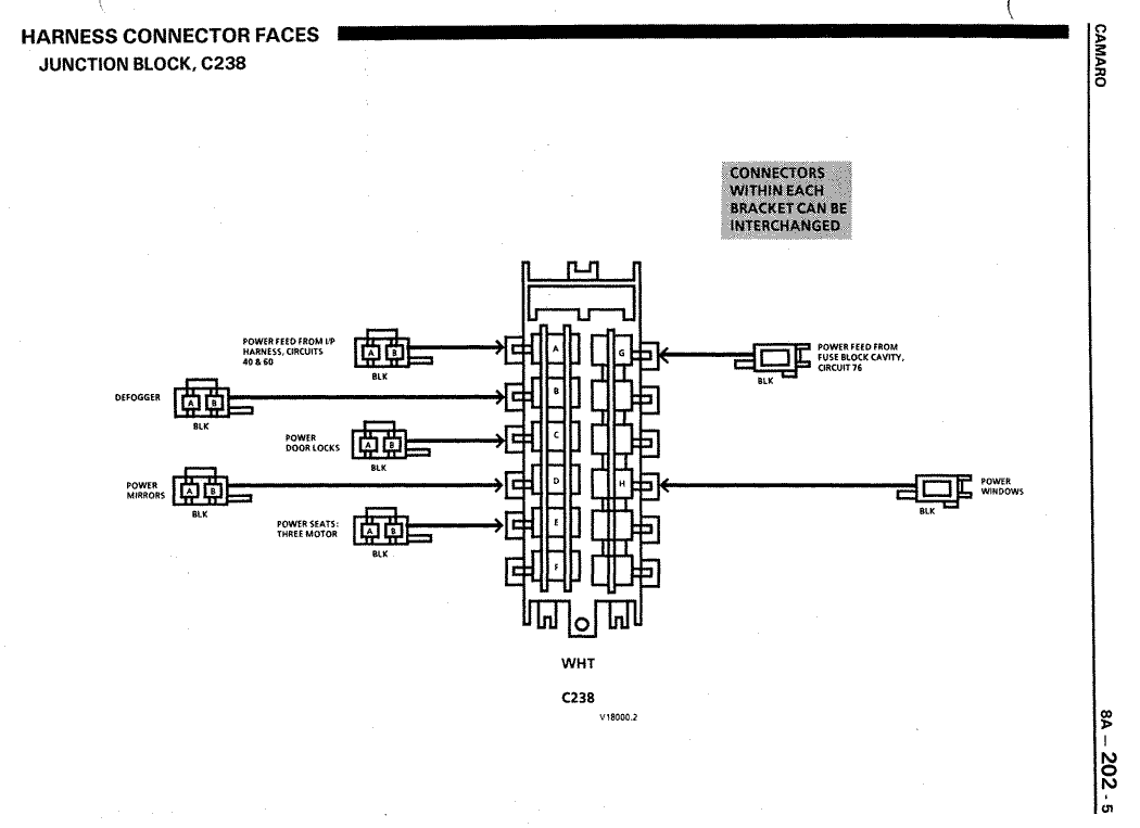

Can someone take a pic of the top (back side) of the fuse pannel on something close to an 82 firebird?
i have 2 wires that are supposed to plug into the back side, but i have no idea which plug they go in.

Hello Dave,
They should plug into something like this and it is mounted under the left kick panel above the hood release cable.

Sweet, thanks man.
i just got the ***** to rip out my whole engine harness from the old Crossfire 305. it think that may have fixed the gauge fuse blowing problem. i also plugged in those wires.....
so far it's still running
