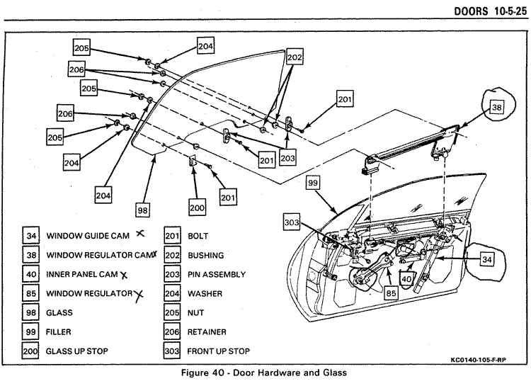

Run the windows down and remove the inner door panel and the plastic weather guard if installed. If you look inside the door panel, you will see the tracks and rollers for the windows. Run the windows back up and take a can of carb cleaner and spray them real good to clean them. If you can get your hand in there with a small toothbrush would be great. Here is a picture of the areas mentioned. After cleaning, lube them good with a spray can of white lithium grease or heavy duty silicone spray lubricant. Clean the connectors with electrical contact cleaner. You can clean those felt pieces but you may have to replace them. If you do replace them, mark their location so you can put them back in the same place.

Sorry, I forgot to include it Here you go!!!!!!!!
