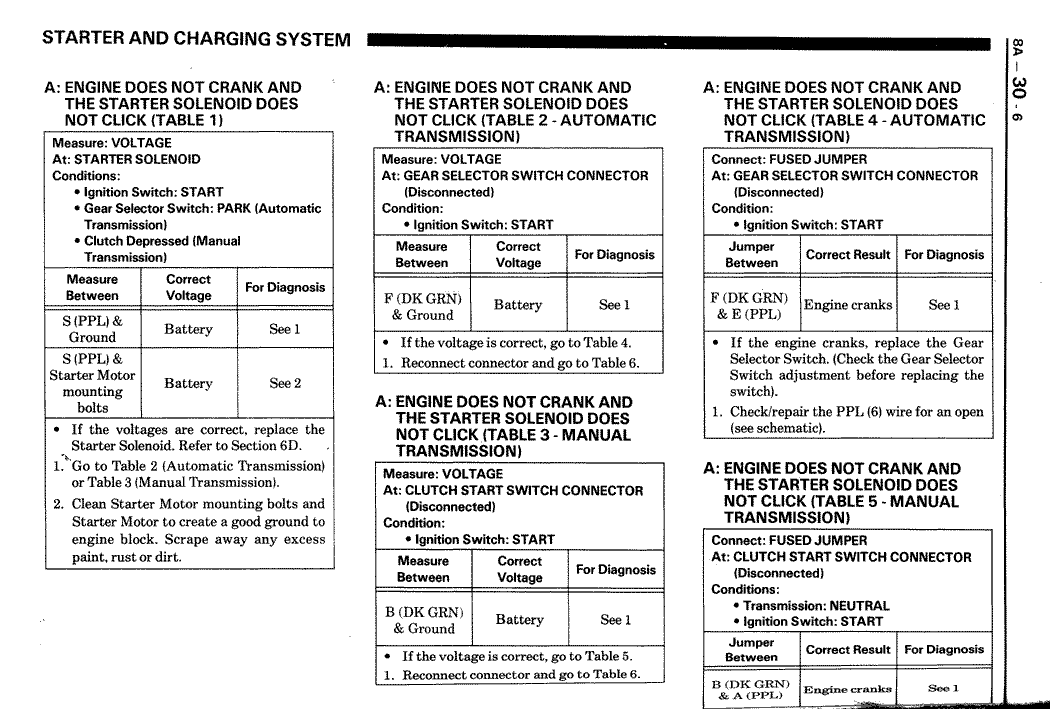

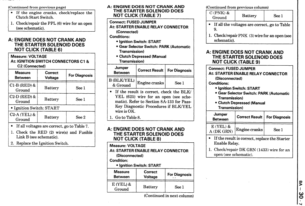

You are correct that the ignition coil gets power from the switched ignition on the pink wire at the ignition switch. If he jumpers the starter with the key in the on position, he is bypassing the fusible link to the ignition switch. If the VATS works, the car will start. Here is a trouble shooting chart for him to check his problem.

page 2
