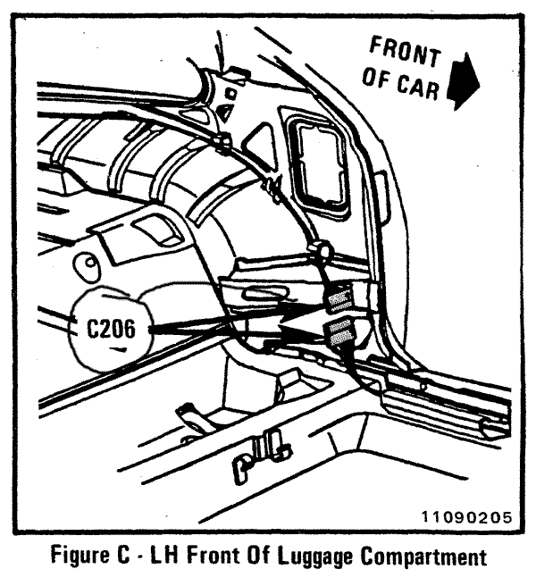

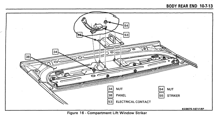

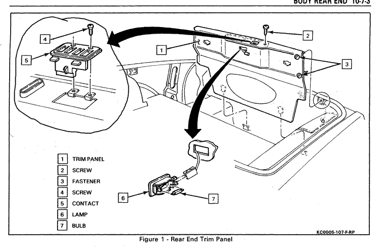

Have you checked the wiring to the electrical contact in the rear trim piece in the cargo area. It makes contact with the electrical contact in the deck lid when the hatch is closed and supplies power to the third stop light when the brake switch is depressed by the brake pedal. See the circled areas in the following pictures.

page 2

page 3

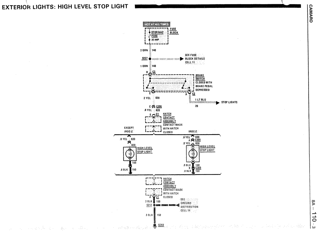

Here is the wiring schematic for it. The wire runs from the brake switch on the brake pedal down the left side of the car to a connector under the trim covering the left rear speaker, From there it goes to the electrical contact in the rear trim piece. See pictures in first post.

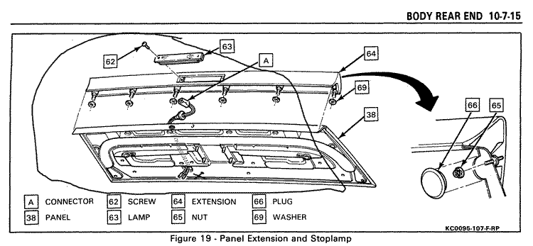

page 2
Also check the fuse shown in the picture.
