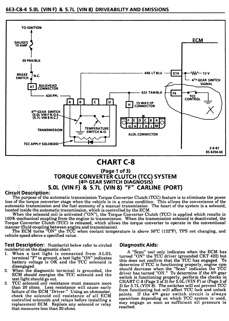

Now I had a look at the diagram below
Now it looks like I tapped into the wrong wire. I tapped into GF6 thinking that the ECM grounds this wire when to engage the Lock Up convertor.
Reading what Vader said it seems like that I should be tapping into the LIGHT BLUE wire that goes to B014 ( 4th gear switch signal).
Where do I find B014 as that is not a pinout on the ECM?
I want the LED to light up when the lock up convertor is engaged so I need to find the wire that the ECM grounds to enable the TCC solenoid?

When the TCC closes the switch at F6 on the ECM that does close the circuit. Give me a minute and I will post the picture of what I'm talking about.

Patience my boy, patience. Okay here are 3 items for you. The first one is a better picture of the one you have above. The second is some reading material explaining a little about the TCC function. The third is a chart shooting that switch to ground in the ECM that I was talking about. First, as I mentioned earlier, you don't need that 12 volt wire spliced in there since there is already 12 volts to it when you turn the key. To show what I mean, if you have one of those test lights. Turn the key to "ON" and put the probe in pin "F" of the ALDL and ground the other end. The light will come on, press the brake pedal and the light will go out. Take a look. BTW, I forgot to mention that wire you were talking about going to the instrument (I/P) panel is pin "H" of the 15 pin connector (C207) under the dash near the ECM.

I tested the circuit out again as I have it wired. Maybe this is how it is meant to be?? But it is weird.
With the key in off position the LED is lighted. When I turn the key to the on position Fuel pump prime etc... The LED goes out.
This has me thinking that the TCC solenoid is grounded by the ECM when the car is turned off. When I turn the key to ON the ECM must open the circuit and wait till criteria is met to ground the wire and enbale the lock convertor.
Could this be the case?
So unless I wire a switch to feed the LED panel I will have the TCC LED on all the time while the car is off.
Does this make sense?

Thanks for that trickster! But I think we are not talking about the same thing.
I don't want to wire up a manual switch to lock the convertor when I want to.
All I want to do is make a LED light up when the TCC solenoid is engaged.
I did not splice 12V into wire that goes into F6 of the ECM. I ran 12v from the battery straight to the LED through a resistor not to burn the LED as it runs off 2.2v normally.
Then I spliced into wire F6 to get ground. Thinking that when the ECM wants to operate the Solenoid it grounds that wire.
Are we talking about the same thing?

Argh looks like what I wanted to do can't be done. As the instructions you posted up say that even when the TCC driver is turned on by the ECM does not mean that the Torque Convertor is engaged.
There goes that idea.
I did the test you said and it works like you say. But the way I have wired up the LED, is that it lights up when the break pedal is pressed.

No, I guess we're not. I included that information so you would know how the TCC functions and would allow you to wire your L.E.D. up so it would operate in the fashion that you want. No mention was made of putting a switch anywhere that would allow you to manually lock up the TCC. Sorry!!!!!!!!!!!!!!

I thought that the circled area in your last picture was a switch. Sorry my mistake So If I connect the LED to that wire and ground the LED it should do the trick. I will give it a go.
I read the information and tested the TCC out and it does behave like written to that is cool.

Cool, BTW those are switches in the circled area. However they are factory mounted inside the ECM. Yes, these service manuals are nice.

Okay Basically all I did was spliced into the TAN/BLK wire F6 on the ECM. Connected that to one LEG of the LED and the other LEG of the LED I connected it to ground.
I have not tested the car out yet to see what this set-up gives me but it might work.
Now with the KEY ON it lights the LED. If I press the brake pedal the LED will turn off.
Now this got me thinking I am kind of confused a little. Now if the LED is on this means that the TCC solenoid is not engaged going by what you posted.
Now if I tap the bake pedal does this mean that the circuit gets interupted?
So now if I take the car for a drive and the LED goes out this should mean that the TCC solenoid is engaged.
