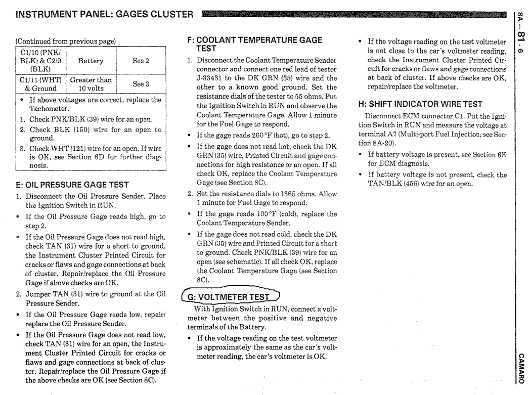

You may have a bad voltmeter in the instrument panel. Here is a test that you can try.

I want that book it went for 55 dollars on ebay
