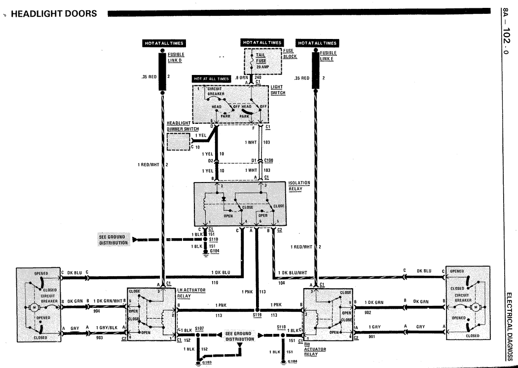

OK, i have an 1986 Trans Am. Everything is fine and now things go wrong. My current problem started about a month ago. My headlights turn on, just dont pop up. I dont think its the motors b/c how could bnoth go at the same time? Alos, when i put them up manually, if i hit the switch down, they go down. My mechanic says it isnt the relays b/c they are clicking. What else could it be? a switch? if so how do i check? Alos, my mechanic recommended me to go to my pontiac dealership( go figure) but i know ill get ripped off. Im 17 and just cant afford to have this whol diagnostic work up, any help would be appreciated...
Adam
Old Jun 25, 2004 | 10:05 AM
Trickster's Avatar
Posts: 6,127
Likes: 12
From: conway, s.c.
Car: 1989 Iroc-Z
Engine: 5.7L TPI
Hello Adam,

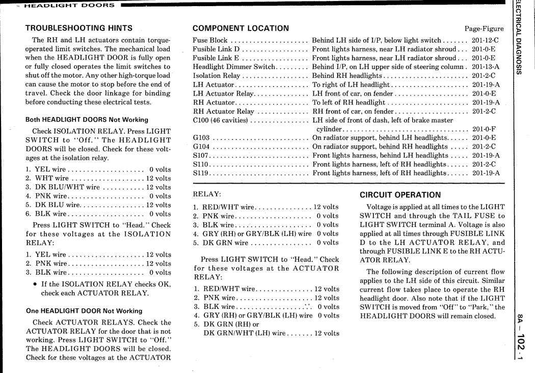

There are three relays in that circuit for the headlight doors. Here is a schematic of the doors and a troubleshooting chart for them that might help you with pinning your problem down.
Old Jun 25, 2004 | 10:06 AM
Trickster's Avatar
Posts: 6,127
Likes: 12
From: conway, s.c.
Car: 1989 Iroc-Z
Engine: 5.7L TPI
page 2
