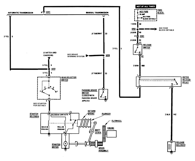

Well what he can do is take the tan/white wire that goes from the hatch release relay and splice it into the yellow wire that goes to pin "F" of the Park/Neutral switch and that way he could open the hatch just by having the shifter in either park or neutral.

Here's a wiring diagram if it helps. If you need a better quality version I could email it to you. It's for an '88 Camaro but your bird should be pretty much the same.
Attached Thumbnails Okay, so how can I pop my hatch with my car running?-hatchrelease.jpg
