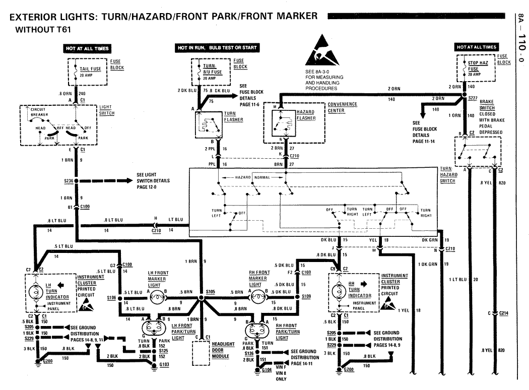

Why would both of my front sidemarkers be out at the same time? New bulbs have no effect. All my other lights/blinkers work fine. Any ideas?

Possible wiring problem between the two sockets.

Yeah... I think there is an electrical problem somewhere.

ok. Does one wire run between both of them?

Maybe this will help!!!!!

wow thanks! Now if only I could read schematics! I actually have all that in the service manual. I was just wondering if there was a "cliff notes" fix.
