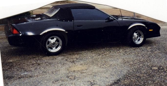

I'm going to install a hatch pulldown on my convertible. I have the release switch and the pulldown, but how do you wire this from scratch so that hatch switch will release the top and allow the solinoid to bring the back hatch up.
this is what i'm talking about:

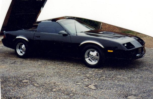

I dont want it to raise it to the position, but just as it does any other camaro. Like state before I already have the Solinoid that I took off a 86 RS in the junkyard today.
Thanks:
82d/504

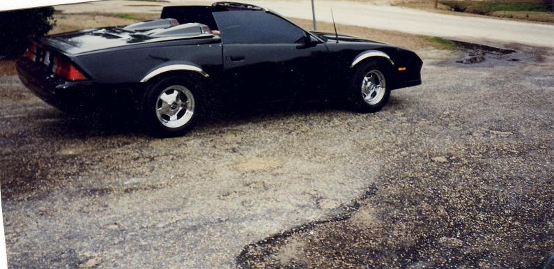

It already has a switch to just release the back, but I want the hatch pulldown to work in conjunction with the release switch.
