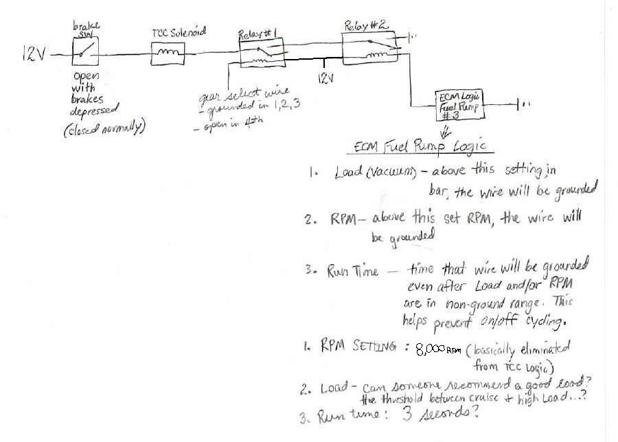

Brief Background:
I am running a R-Trim Superram 355 with a Haltech DFI system. I am not able to use the TCC lockup logic in the DFI system (because nitrous requires the use of the same input wire).
Idea:
Use fuel pump (you can set up unlimited fuel pumps) logic from the DFI system to control TCC lockup using the "load" threshold. This is a lot like the TCI pressure switch kits! I attached a diagram of how it should be done I think. Please give me some suggestions on what a good vacuum setting should be and correct me if anything looks wrong. Thanks!
