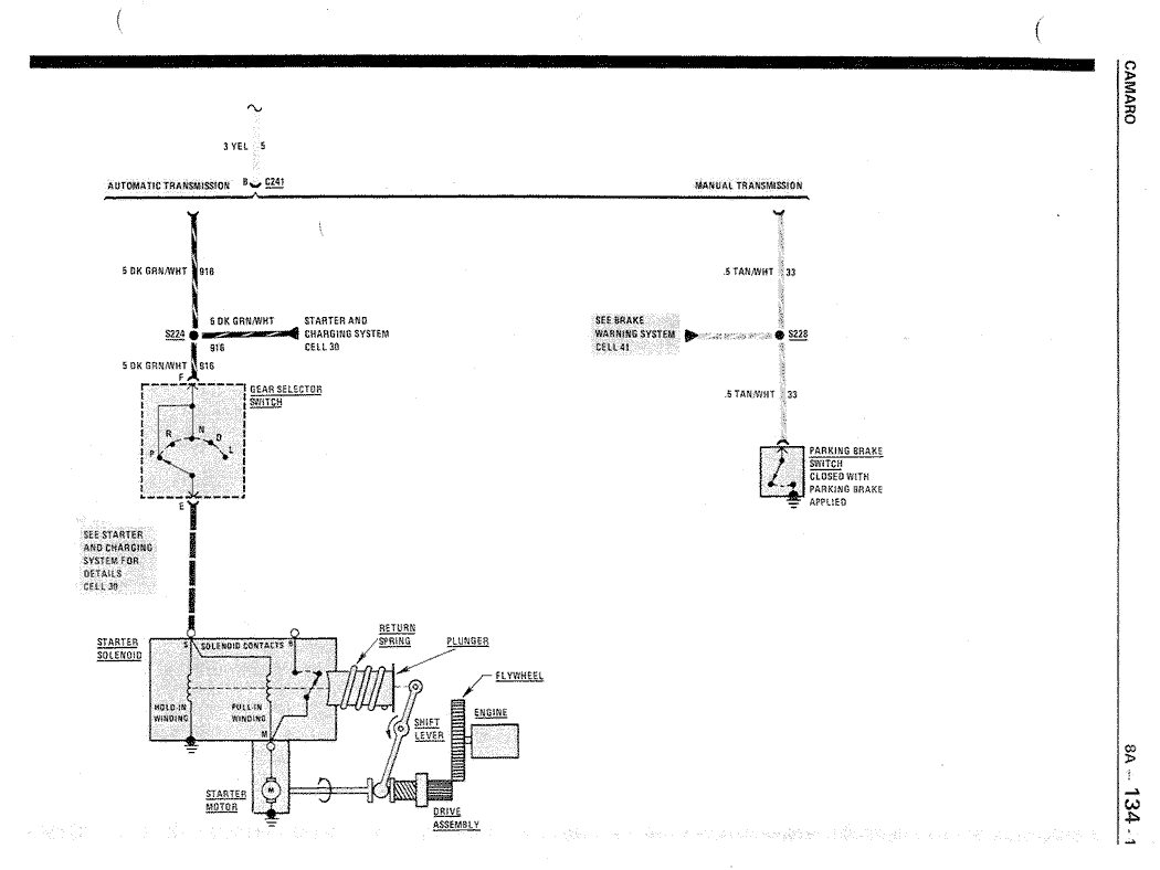

My '89 did not originally come with a pop up button for the trunk. However, I believe the wiring is there for it. Does anyone have a diagram for this or maybe it is as simple as putting in a fuse or relay. I checked the fuel panel and I see not provision for a fuse for it. I do have a switch to allow this. Any help will be appreciated! Thanks folks!!

Uh...Huh!!!!!!!! The two fuses that you want are the "ACC" & "LID" fuses.

page 2
