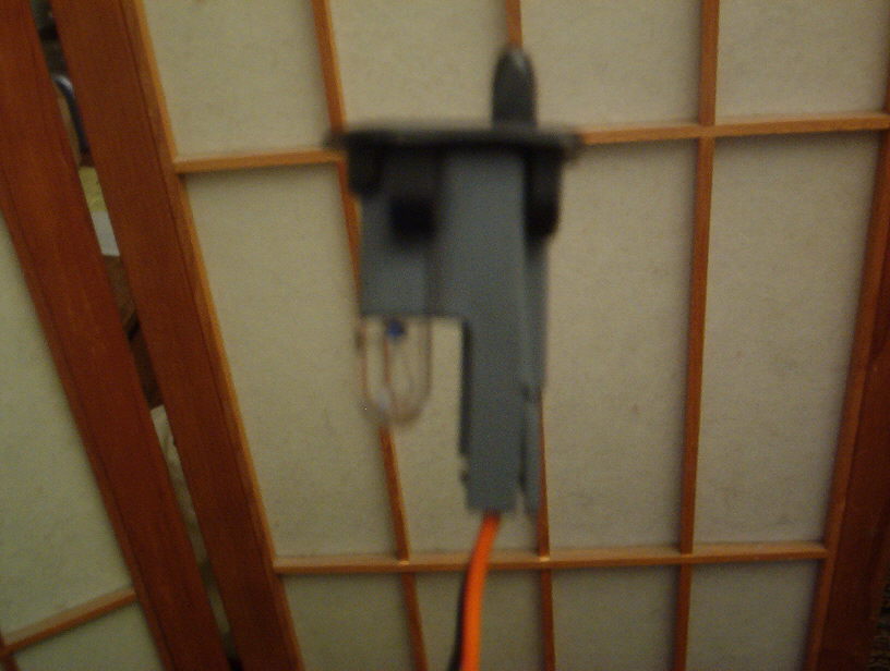

Is this the light?I got at the yard today out of a 85 camaro.
Posts: 2,492
From: Arcadia ,Ca
Transmission: TH200C....700R4
Ok.Im guessing thats the light.So if it is where can I get power for it?Do I need to take those wires straight to the fuse box or is there something closer I can splice it into?

Yay! Its in and connected .Works perfect.Thanks Everyone,Imean dans71ta!
