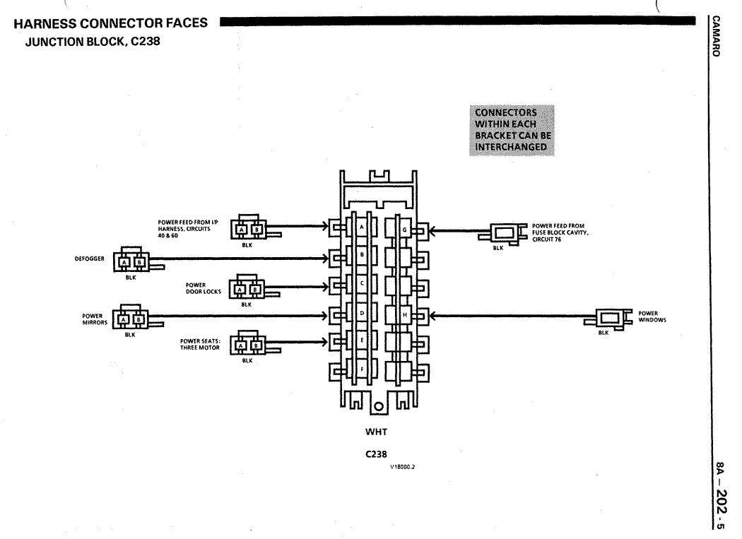

My power windows do not work on this 85 camaro I bought. The previous owner did a butchery of the wires underneath. I noticed that each power window has 2 wires? Leading from it into the window. Where exactly is the power for the windows coming from in the fuse box? THANKS!!!

If you will look behind the left kick panel on the drivers side and up above the hood release cable. You will find this power junction box (also known as connector C238), this is where the power for the windows, power seats, and door locks comes from.

hmm.. well, I can hotwire my windows to work going off of that powerwire, but they wont work otherwise.. would that be either bad switches or bad wiring going to/from the switches?
