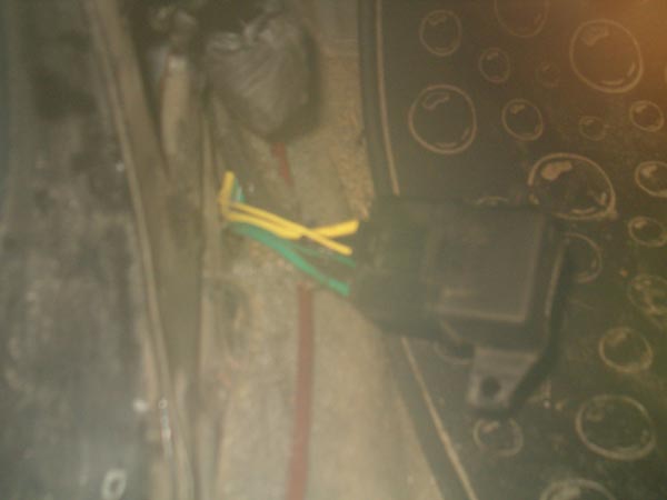

Have you looked at the starter enable relay in the left kick panel? Try checking the power at the two yellow wires with the key in the on position.

Very interesting, Trickster does my 1988 IROC also have a Starter enable rely? It does not have Vats.

Since you have mentioned that your car does not have VATS, it is unlikely that you would have one. The only way that you would have one is if it was a late production model or what was considered a high value model. You can tell by looking under the left kick panel and it will look like this.

o.k. when you say kick panel you mean that area on the left side of the car under the dash correct? Not somewhere in the back of the car?
Also, Thanks for the pic
Old Aug 19, 2004 | 10:46 PM
Trickster's Avatar
Posts: 6,127
Likes: 12
From: conway, s.c.
Car: 1989 Iroc-Z
Engine: 5.7L TPI
Yep!!!!!!!!!, it is the panel with the hood release cable.

Starter enable relay
Can you tell me where the small yellow and green wires go to and come from?
Thanx
Old Apr 6, 2005 | 12:07 AM
Trickster's Avatar
Posts: 6,127
Likes: 12
From: conway, s.c.
Car: 1989 Iroc-Z
Engine: 5.7L TPI
Yep, the small yellow wire comes from the ignition switch and goes to the starter enable relay. The small green wire goes from the starter enable relay and goes to the VATS control module pin "A3". BTW, both yellow wires come from the ignition switch and the large green wire goes to pin "F" of the P/N switch (automatic) or the clutch safety switch (manual).
