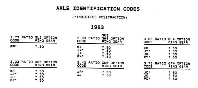

I've been doing some research on the rearend in my 83 Z.
My father in-law, who is the original owner, said he ordered the car with a 4:10 posi. So I looked at the code stamped on the passenger side axle tube and it looks like 5JK. I'm not sure what the 5 is for, but in my research JK is supposed to be a 3:73 open diff. However, mine is definitely a posi.
Did I read the code wrong?
Maybe it is JR? Which is a 3:42 posi.
​​​​If so, the car tachs 2300rpm at 60. Is that right for a 3:42 gear?

I never really looked into the codes on the axle itself. Your best bet is the look at your RPO codes. Another option is to plug in the information you do have into one of those online rear gear calculators. Calculate RPM for Given Speed(MPH), Rear Gear Ratio, and Trans Gear Ratio You can plug in your speed, rpm, tire diameter (I'm guessing not stock size tire if you changed wheels) and your final drive of your trans to get your axle. For example 60 mph at 2300rpm and if you had stock 215-65-15 tires makes them 26" tall with the 700r4 that has a 0.70 final gear that would put your rear gear around the 4.10 mark

I just did the calculations. My 5spd final drive is .74 and my rear tires are 25in, 255/40/17. So 2300 at 60 calculates out to 3:73. That tells me code JK is correct, but it's a posi and not a open diff as the code JK suggests.

Re: Code 5JK stamped on the axle tube 3:73 Posi?
JK Is Not Posi
