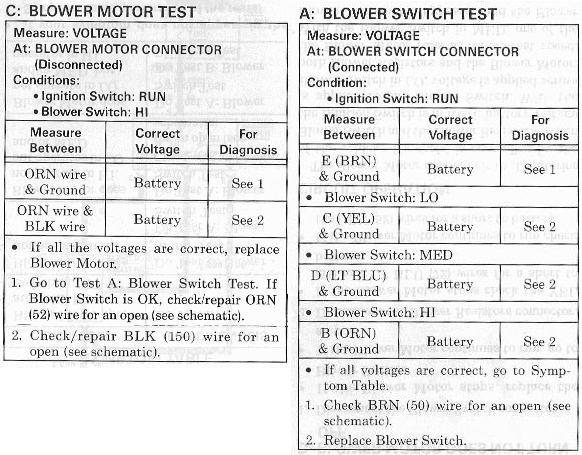

First, make sure the fuse isn't blown. The blower fuse is the 25 amp fuse in the upper right corner of your picture, labled HTR A/C, then an arrow toward the fuse.
If the fuse is good, check if power is getting to the blower motor. Use a volt meter, or a test light with the ignition ON and the fan switch on HI. Make sure the selector is not in the OFF position. The wire should be orange. Measure the voltage between the orange wire and ground, and between the orange wire and the black wire. They both should read 12 volts.
If power is getting to the motor and the motor doesn't run, the motor is bad or there is a bad connection.
If you are not getting power to the motor, and the fuse is good, then the switch is bad or there is a bad connection elsewhere.

From the 1991 shop manual...
