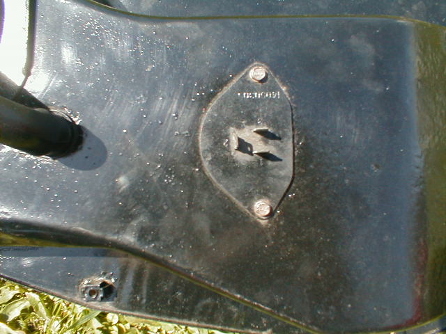

Currently this is about the best I can do for you. (Away from home and the car currently)

The following are smaller than the purple power wire:
Right column top most --> Yellow
Right column middle --> Tan
Right column lower --> Light Blue
Hope this helps!

Looks like you have the non AC resistor pictured (my PN is 14090309 for the one I have). That being said I'm considering you have a single prong wire setup on your AC blower motor that matches your non AC blower. If that's true then the wiring harness of the AC and Non AC probably is the same or very similar.
The resistor that came supplied with my 1LE box had the following wiring:
Blue to side prong (Labeled #2 on my part)
2 Oranges to the top (Labeled #3, the one the closest to the PN)
Yellow to the lower prong (Labeled #1)
The orange color is the power wire. You'll want to take the 2nd orange wire coming off the resistor and hook it up to the blower motor.
My black wire doesn't even connect through the main harness. It's just a simple Chassis to blower motor face. It's the ground wire. I'm assuming if you connect up the yellow, orange, and blue to your cut harness and run the ground wire it'll work. Course all bets are off cause I'm just guessing here.

Looks to me that one is red not orange.
You need to run the orange wire up to the connector labeled #3 (there labeled for this reason
) on the resistor and then just run another wire piggy backed off the orange to the power connection on the blower.
The orange is just one wire off the main harness not 2. You only get the 2nd when you splice into the orange and run the spliced wire onto the blower green prong. From my understanding that's the power.
The green prong will be your power connection. You need to use a ring connector or something similar (I would use the connection you have under that screw in the corner) to that under a screw on the motor plate for the ground. So you will have 2 wires total on the blower unit.
