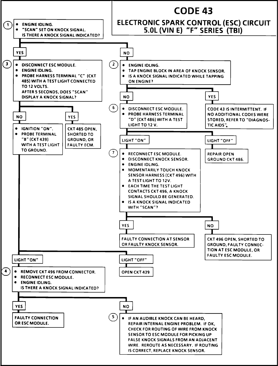

hope this works...here is a code 43 diagnostic chart

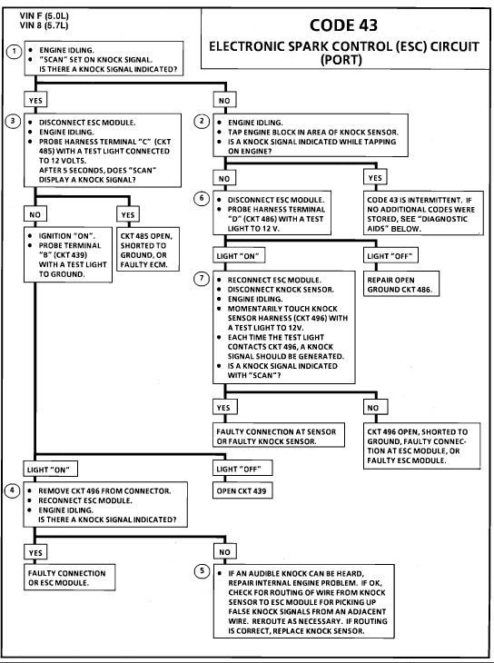

here one for tpi...david_0161 car is a tbi so I posted chart for it...hope this helps...
